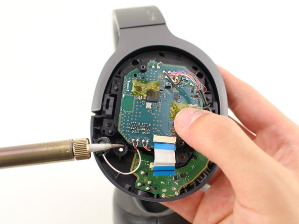

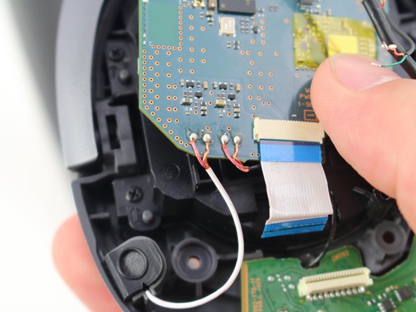

  3. Sony H.ear On 2 Motherboard Replacement: crwdns2935265:03crwdnd2935265:01crwdnd2935265:03crwdne2935265:0 Sony H.ear On 2 Motherboard Replacement: crwdns2935265:03crwdnd2935265:02crwdnd2935265:03crwdne2935265:0 Sony H.ear On 2 Motherboard Replacement: crwdns2935265:03crwdnd2935265:03crwdnd2935265:03crwdne2935265:0
    • De-solder all 18 wire-connections on the motherboard.
    • Record wire positions on board for proper connections when re-soldering the replacement board.
    • Do not overheat joints while de-soldering to prevent board damage.
    • Please see How To Solder and Desolder Connections for help on soldering and desoldering connections.

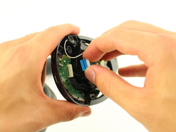

  4. Sony H.ear On 2 Motherboard Replacement: crwdns2935265:04crwdnd2935265:01crwdnd2935265:02crwdne2935265:0 Sony H.ear On 2 Motherboard Replacement: crwdns2935265:04crwdnd2935265:02crwdnd2935265:02crwdne2935265:0
    • Disconnect the white ribbon cable by gently tugging on the white connector while holding the motherboard carefully in place.
