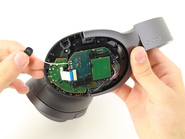

  3. Sony H.ear On 2 Microphone Replacement, Noise Cancelling Microphone: crwdns2935265:03crwdnd2935265:01crwdnd2935265:03crwdne2935265:0 Sony H.ear On 2 Microphone Replacement, Noise Cancelling Microphone: crwdns2935265:03crwdnd2935265:02crwdnd2935265:03crwdne2935265:0 Sony H.ear On 2 Microphone Replacement, Noise Cancelling Microphone: crwdns2935265:03crwdnd2935265:03crwdnd2935265:03crwdne2935265:0
    • Use the iFixit plastic opening tool to lift the microphone out of its housing
    • Use gentle pressure to prevent damaging small wire connections

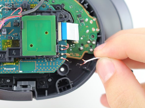

  4. Sony H.ear On 2 Microphone Replacement: crwdns2935265:04crwdnd2935265:01crwdnd2935265:02crwdne2935265:0 Sony H.ear On 2 Microphone Replacement: crwdns2935265:04crwdnd2935265:02crwdnd2935265:02crwdne2935265:0
    • Use soldering iron to desolder microphone wires from motherboard
    • Please see How to Solder and Desolder Connections before you attempt to use the soldering iron.
    • Note: Do not overheat joints while de-soldering to prevent board damage
