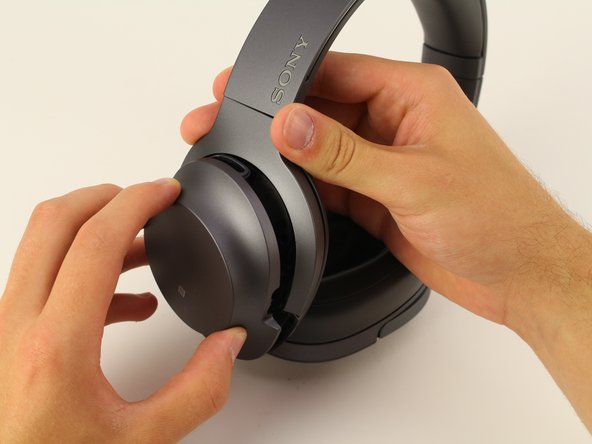

  1. Sony H.ear On 2 Bluetooth Transceiver Replacement, Ear Cup: crwdns2935265:01crwdnd2935265:01crwdnd2935265:02crwdne2935265:0 Sony H.ear On 2 Bluetooth Transceiver Replacement, Ear Cup: crwdns2935265:01crwdnd2935265:02crwdnd2935265:02crwdne2935265:0
    • Start by inserting the iFixit plastic opening tool in the crease between the hard plastic and the ear cup, and then gently apply pressure until it separates. You may need to repeat the process on back until it is completely separate.
    • This may take a considerable amount of pressure, but do not force it.

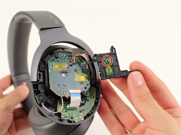

  3. Sony H.ear On 2 Bluetooth Transceiver Replacement, Bluetooth Transceiver: crwdns2935265:03crwdnd2935265:01crwdnd2935265:02crwdne2935265:0 Sony H.ear On 2 Bluetooth Transceiver Replacement, Bluetooth Transceiver: crwdns2935265:03crwdnd2935265:02crwdnd2935265:02crwdne2935265:0
    • Use the JIS #00 Screwdriver to remove the five 6.4 mm screws holding the back plastic cover in place.
    • Then, turn the ear cup over and carefully lift the plastic cover off to reveal the internal components of the right ear cup.
    • Unlike the right ear cup, there is no ribbon cable directly connecting the rest of the headphones to the outer cup.

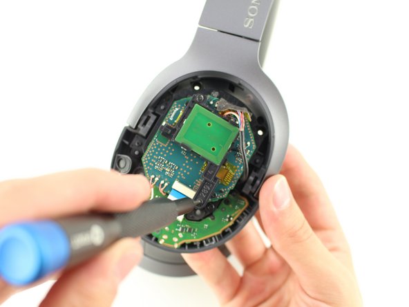

  4. Sony H.ear On 2 Bluetooth Transceiver Replacement: crwdns2935265:04crwdnd2935265:01crwdnd2935265:03crwdne2935265:0 Sony H.ear On 2 Bluetooth Transceiver Replacement: crwdns2935265:04crwdnd2935265:02crwdnd2935265:03crwdne2935265:0 Sony H.ear On 2 Bluetooth Transceiver Replacement: crwdns2935265:04crwdnd2935265:03crwdnd2935265:03crwdne2935265:0
    • Using the JIS #00 screwdriver, remove the two 6.4 mm screws holding the NFC chip in place over the motherboard.
    • Once the screws are removed, gently turn over the board to the left to expose the soldered connection points.

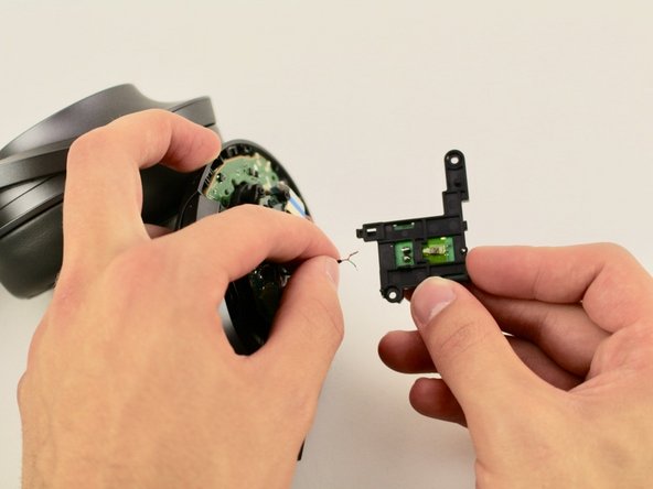

  5. Sony H.ear On 2 Bluetooth Transceiver Replacement: crwdns2935265:05crwdnd2935265:01crwdnd2935265:02crwdne2935265:0 Sony H.ear On 2 Bluetooth Transceiver Replacement: crwdns2935265:05crwdnd2935265:02crwdnd2935265:02crwdne2935265:0
    • Using a soldering iron, carefully de-solder the two connection points on the NFC chip.
    • Once the solder has completely melted, carefully separate the wires and the NFC chip itself.
    • Please see How to Solder and Desolder Connections before you attempt to use the soldering iron.
