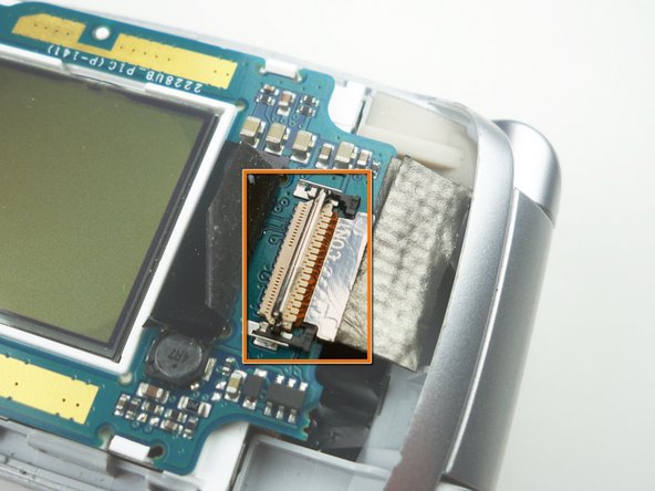

  7. Sony Ericsson z300 Front Speaker Replacement, Screens: crwdns2935265:07crwdnd2935265:01crwdnd2935265:01crwdne2935265:0
    • Use a plastic opening tool to lift the black tape off of the ribbon cable connector.
  8. Sony Ericsson z300 Front Speaker Replacement: crwdns2935265:08crwdnd2935265:01crwdnd2935265:01crwdne2935265:0
    • Lift the ribbon cable connector lock using a plastic opening tool.
  9. Sony Ericsson z300 Front Speaker Replacement: crwdns2935265:09crwdnd2935265:01crwdnd2935265:02crwdne2935265:0 Sony Ericsson z300 Front Speaker Replacement: crwdns2935265:09crwdnd2935265:02crwdnd2935265:02crwdne2935265:0
    • Slide the black ribbon cable tray out with a plastic opening tool.
    • Shown in the second picture is the try already slid out.
