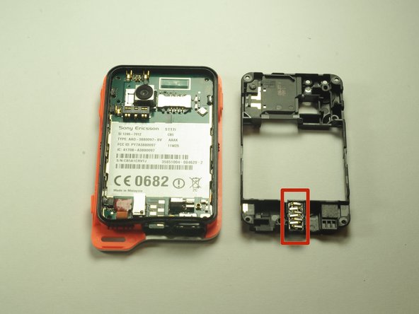

  4. Sony Ericsson xPeria Active Screen Replacement, Unfastening The Motherboard Cover: crwdns2935265:04crwdnd2935265:01crwdnd2935265:01crwdne2935265:0
    • Unscrew the 5mm screws with the T5 head.
    • Unscrew the 6mm screw with the T6 head.

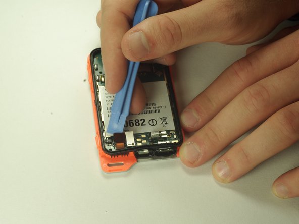

  5. Sony Ericsson xPeria Active Screen Replacement, Removing The Motherboard Cover: crwdns2935265:05crwdnd2935265:01crwdnd2935265:02crwdne2935265:0 Sony Ericsson xPeria Active Screen Replacement, Removing The Motherboard Cover: crwdns2935265:05crwdnd2935265:02crwdnd2935265:02crwdne2935265:0
    • Remove the black cover with the plastic opening tool.
    • Remove the headphone jack from its slot.

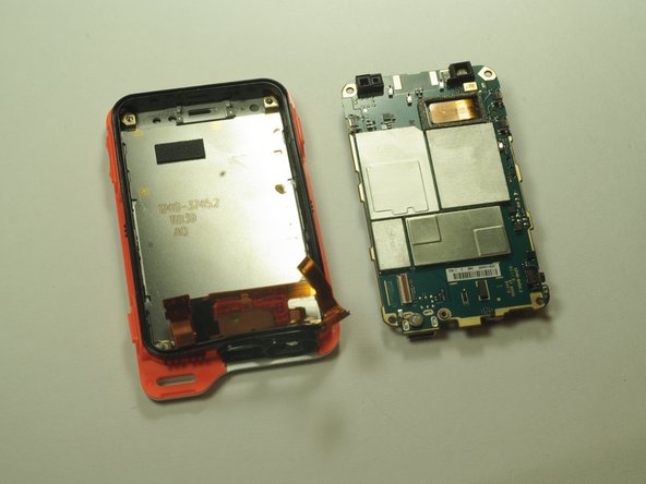

    • Unplug the power cable by carefully prying it away from the motherboard.
  7. Sony Ericsson xPeria Active Screen Replacement: crwdns2935265:07crwdnd2935265:01crwdnd2935265:02crwdne2935265:0 Sony Ericsson xPeria Active Screen Replacement: crwdns2935265:07crwdnd2935265:02crwdnd2935265:02crwdne2935265:0
    • Remove the power strip on the back side of the motherboard.

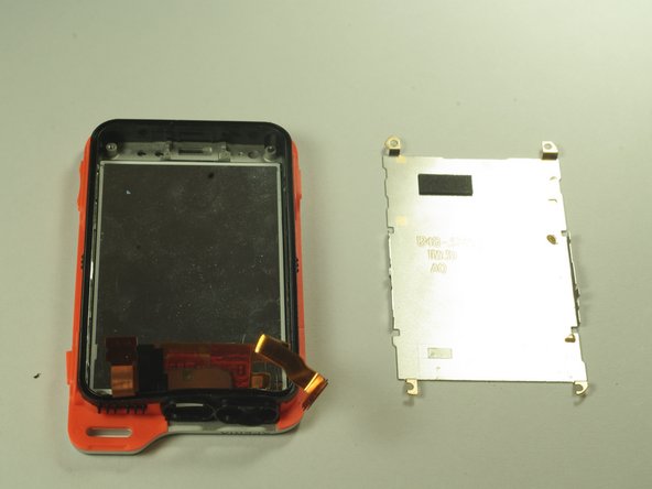

  8. Sony Ericsson xPeria Active Screen Replacement, Remove back screen shield: crwdns2935265:08crwdnd2935265:01crwdnd2935265:02crwdne2935265:0 Sony Ericsson xPeria Active Screen Replacement, Remove back screen shield: crwdns2935265:08crwdnd2935265:02crwdnd2935265:02crwdne2935265:0
    • Remove the shield.

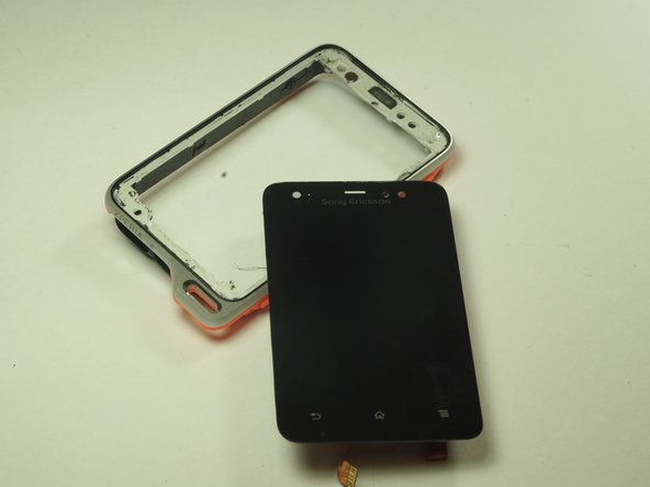

  9. Sony Ericsson xPeria Active Screen Replacement, Remove the screen module: crwdns2935265:09crwdnd2935265:01crwdnd2935265:02crwdne2935265:0 Sony Ericsson xPeria Active Screen Replacement, Remove the screen module: crwdns2935265:09crwdnd2935265:02crwdnd2935265:02crwdne2935265:0
    • Push the screen through the front of the case, gently.
    • It may be a little tough, just work your way around the edges of the screen until it separates from the main case.
