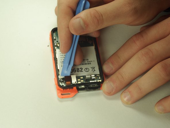

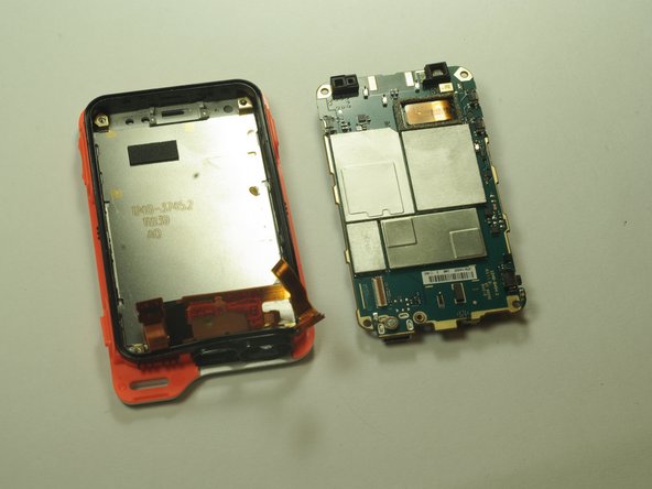

  7. Sony Ericsson xPeria Active Camera Replacement, Remove motherboard from device case.: crwdns2935265:07crwdnd2935265:01crwdnd2935265:01crwdne2935265:0
    • Using the plastic opening tool, carefully pry up on the edges of the motherboard, opposite of the jacks.

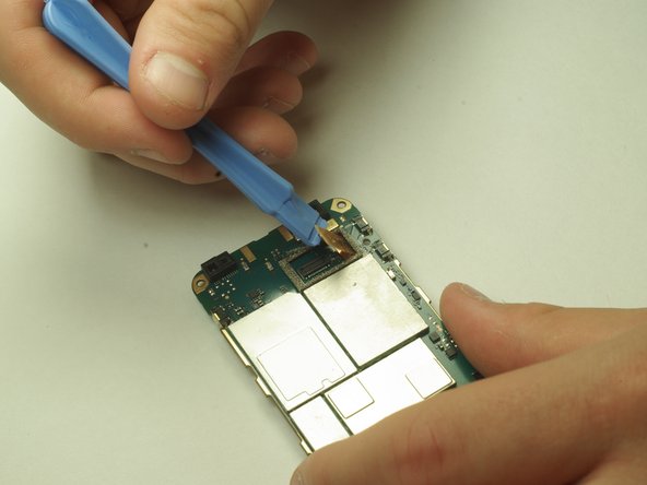

  8. Sony Ericsson xPeria Active Camera Replacement, Remove the display ribbon cable: crwdns2935265:08crwdnd2935265:01crwdnd2935265:02crwdne2935265:0 Sony Ericsson xPeria Active Camera Replacement, Remove the display ribbon cable: crwdns2935265:08crwdnd2935265:02crwdnd2935265:02crwdne2935265:0
    • Carefully pry up on the tab holding down the display ribbon cable and remove the ribbon cable.
  9. Sony Ericsson xPeria Active Camera Replacement: crwdns2935265:09crwdnd2935265:01crwdnd2935265:02crwdne2935265:0 Sony Ericsson xPeria Active Camera Replacement: crwdns2935265:09crwdnd2935265:02crwdnd2935265:02crwdne2935265:0
    • Use the plastic opening tool to pry the ribbon cable away from the motherboard.

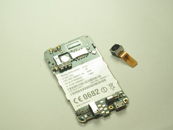

  10. Sony Ericsson xPeria Active Camera Replacement, Remove camera from device: crwdns2935265:010crwdnd2935265:01crwdnd2935265:02crwdne2935265:0 Sony Ericsson xPeria Active Camera Replacement, Remove camera from device: crwdns2935265:010crwdnd2935265:02crwdnd2935265:02crwdne2935265:0
    • Pull the camera out through the front of the motherboard.
