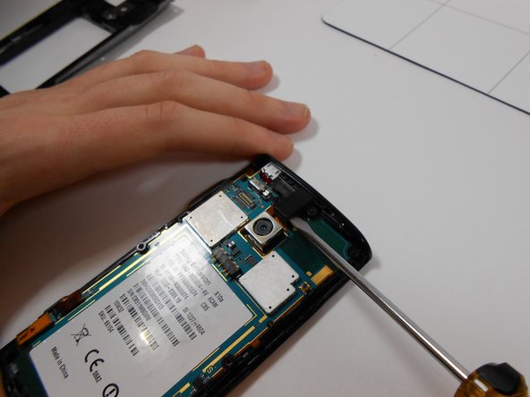

      • Remove the volume and camera buttons. Using your fingers or a screwdriver, pull off the black plastic piece on the very top of the phone.

    11. Sony Ericsson Xperia X10 Screen Replacement: crwdns2935265:011crwdnd2935265:01crwdnd2935265:02crwdne2935265:0 Sony Ericsson Xperia X10 Screen Replacement: crwdns2935265:011crwdnd2935265:02crwdnd2935265:02crwdne2935265:0
      • Using a flat head screw driver, disconnect the glue holding the left ribbon cable to the phone. Pull up the black plastic piece being pointed to in the image.
