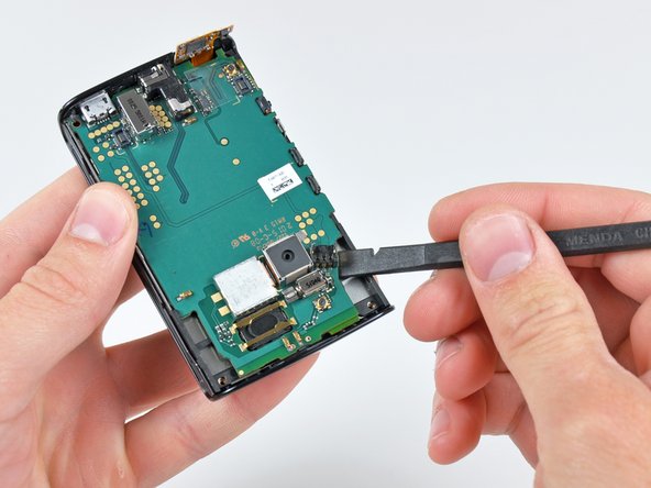

    • The 5 MP camera, battery connector, vibrator motor, and speaker are densely packed on the logic board near the top of the phone.
    • After disconnecting the touchscreen connector, the logic board can be carefully pried out of its enclosure.

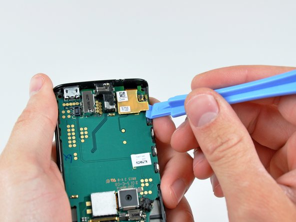

  10. Sony Ericsson Xperia X10 Mini E10i Teardown: crwdns2935265:010crwdnd2935265:01crwdnd2935265:03crwdne2935265:0 Sony Ericsson Xperia X10 Mini E10i Teardown: crwdns2935265:010crwdnd2935265:02crwdnd2935265:03crwdne2935265:0 Sony Ericsson Xperia X10 Mini E10i Teardown: crwdns2935265:010crwdnd2935265:03crwdnd2935265:03crwdne2935265:0
    • Rotate the logic board upward out of its cradle and use an iPod opening tool to disconnect the display data ribbon cable.
    • The shields covering the majority of the chips housed on the logic board protect their sensitive circuitry from electromagnetic interference.

he great take apart, do you need to dissemble the whole phone to replace the power button cap?
Alex - crwdns2934203:0crwdne2934203:0
More or less. It's been a while since I took this apart, but I think you'll have to take the logic board out (work up to step 9). Luckily, this phone is really straightforward to disassemble.
