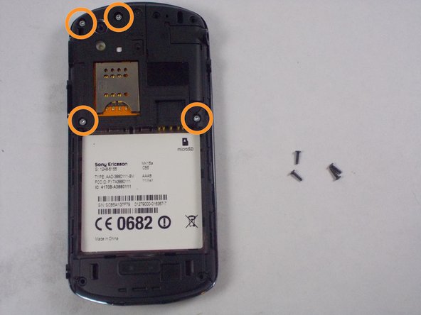

  3. Sony Ericsson Xperia Pro MK16A Power Button Replacement, Remove Screws: crwdns2935265:03crwdnd2935265:01crwdnd2935265:03crwdne2935265:0 Sony Ericsson Xperia Pro MK16A Power Button Replacement, Remove Screws: crwdns2935265:03crwdnd2935265:02crwdnd2935265:03crwdne2935265:0 Sony Ericsson Xperia Pro MK16A Power Button Replacement, Remove Screws: crwdns2935265:03crwdnd2935265:03crwdnd2935265:03crwdne2935265:0
    • Remove the 4 black screws with the Phillips screwdriver.
    • Remove the 4 silver screws with the Torx screwdriver.
