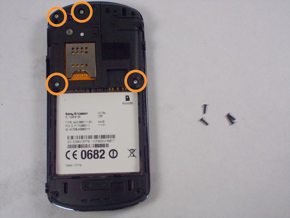

  3. Sony Ericsson Xperia Pro MK16A Camera Replacement, Remove Screws: crwdns2935265:03crwdnd2935265:01crwdnd2935265:03crwdne2935265:0 Sony Ericsson Xperia Pro MK16A Camera Replacement, Remove Screws: crwdns2935265:03crwdnd2935265:02crwdnd2935265:03crwdne2935265:0 Sony Ericsson Xperia Pro MK16A Camera Replacement, Remove Screws: crwdns2935265:03crwdnd2935265:03crwdnd2935265:03crwdne2935265:0
    • Remove the 4 black screws with the Phillips screwdriver.
    • Remove the 4 silver screws with the Torx screwdriver.

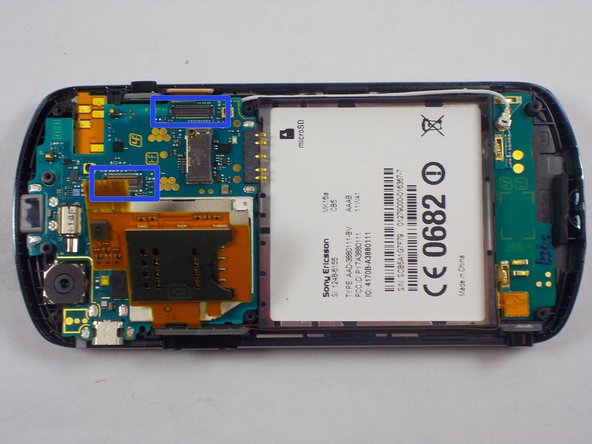

  4. Sony Ericsson Xperia Pro MK16A Camera Replacement, Remove Back Case: crwdns2935265:04crwdnd2935265:01crwdnd2935265:01crwdne2935265:0
    • Insert the plastic opening tool in between the two halves of the case. Pry around the phone to detach the back case.

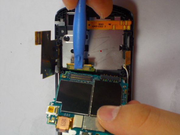

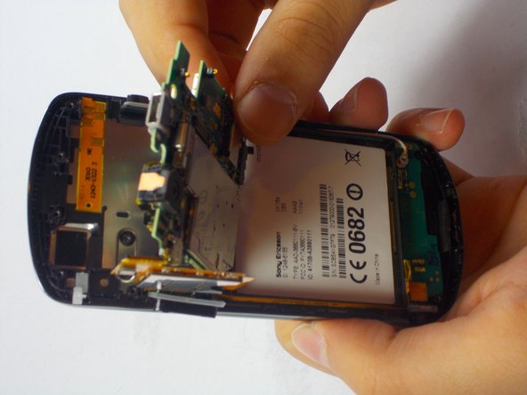

  5. Sony Ericsson Xperia Pro MK16A Camera Replacement, Access the Logic Board: crwdns2935265:05crwdnd2935265:01crwdnd2935265:03crwdne2935265:0 Sony Ericsson Xperia Pro MK16A Camera Replacement, Access the Logic Board: crwdns2935265:05crwdnd2935265:02crwdnd2935265:03crwdne2935265:0 Sony Ericsson Xperia Pro MK16A Camera Replacement, Access the Logic Board: crwdns2935265:05crwdnd2935265:03crwdnd2935265:03crwdne2935265:0
    • Remove the last screw that is connecting the logic board using the Phillips screwdriver.
    • Undo the two ribbons.

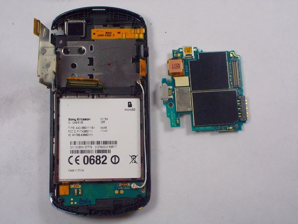

  6. Sony Ericsson Xperia Pro MK16A Camera Replacement, Remove the Logic Board: crwdns2935265:06crwdnd2935265:01crwdnd2935265:03crwdne2935265:0 Sony Ericsson Xperia Pro MK16A Camera Replacement, Remove the Logic Board: crwdns2935265:06crwdnd2935265:02crwdnd2935265:03crwdne2935265:0 Sony Ericsson Xperia Pro MK16A Camera Replacement, Remove the Logic Board: crwdns2935265:06crwdnd2935265:03crwdnd2935265:03crwdne2935265:0
    • Undo that last connector.

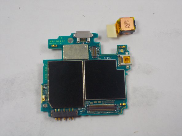

  7. Sony Ericsson Xperia Pro MK16A Camera Replacement, Remove Camera: crwdns2935265:07crwdnd2935265:01crwdnd2935265:02crwdne2935265:0 Sony Ericsson Xperia Pro MK16A Camera Replacement, Remove Camera: crwdns2935265:07crwdnd2935265:02crwdnd2935265:02crwdne2935265:0
    • Lift the camera off of its connector on the logic board.
