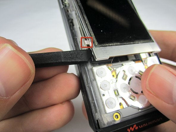

  4. Sony Ericsson W580i LCD Replacement, LCD: crwdns2935265:04crwdnd2935265:01crwdnd2935265:02crwdne2935265:0 Sony Ericsson W580i LCD Replacement, LCD: crwdns2935265:04crwdnd2935265:02crwdnd2935265:02crwdne2935265:0
    • Insert a spudger between the lower edge of the screen and the phone.
    • Pry the screen up to disconnect the tabs on each side holding the screen in.
    • Do not remove the screen yet. There is a ribbon connecting the screen to the motherboard.

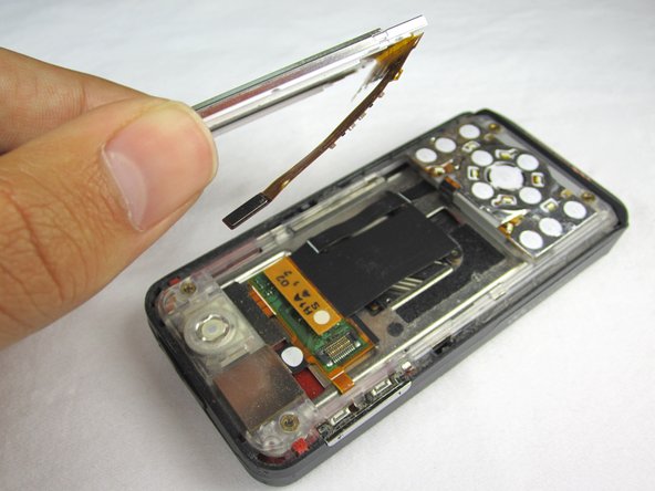

  5. Sony Ericsson W580i LCD Replacement: crwdns2935265:05crwdnd2935265:01crwdnd2935265:02crwdne2935265:0 Sony Ericsson W580i LCD Replacement: crwdns2935265:05crwdnd2935265:02crwdnd2935265:02crwdne2935265:0
    • Use a spudger to remove the ribbon cable from the motherboard.
    • Lift the screen away from the phone
