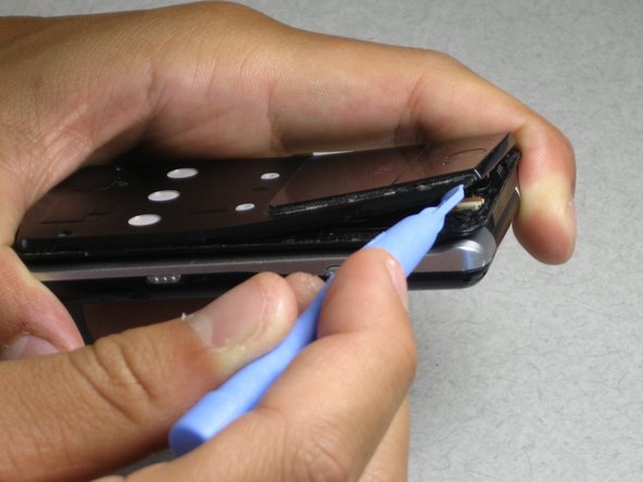

    • Find the small notch on the side of the phone. The notch is located by the "fast-forward" button and the "lock" switch.
  2. Sony Ericsson W518a Camera Lens Replacement: crwdns2935265:02crwdnd2935265:01crwdnd2935265:03crwdne2935265:0 Sony Ericsson W518a Camera Lens Replacement: crwdns2935265:02crwdnd2935265:02crwdnd2935265:03crwdne2935265:0 Sony Ericsson W518a Camera Lens Replacement: crwdns2935265:02crwdnd2935265:03crwdnd2935265:03crwdne2935265:0
    • Insert your plastic opening tool into the notch.
    • Pry off the faceplate by gently sliding the plastic opening tool around the phone while still keeping the tool under the edge of the phone.
    • When enough of the faceplate has been lifted it can be easily removed.
    • In order to replace the faceplate, simply press and snap the faceplate back onto the front of the phone.

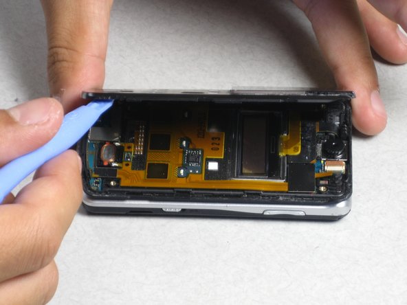

    • Remove the four 2mm Phillips screws from the back housing of the phone.
  4. Sony Ericsson W518a Camera Lens Replacement: crwdns2935265:04crwdnd2935265:01crwdnd2935265:03crwdne2935265:0 Sony Ericsson W518a Camera Lens Replacement: crwdns2935265:04crwdnd2935265:02crwdnd2935265:03crwdne2935265:0 Sony Ericsson W518a Camera Lens Replacement: crwdns2935265:04crwdnd2935265:03crwdnd2935265:03crwdne2935265:0
    • Insert the plastic opening tool in the notch at the top corner of the phone.
    • Lift the corner and run the plastic opening tool around the phone until the back housing can easily be removed.

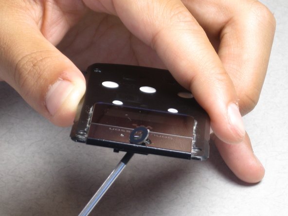

    • Remove the lends by pushing the lens from the inside of the housing.
