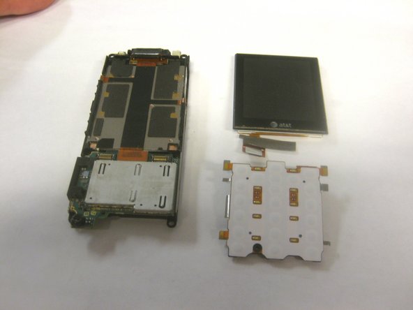

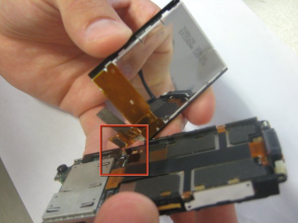

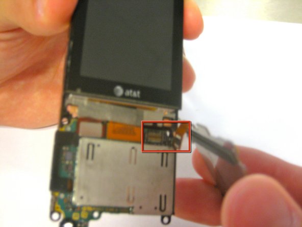

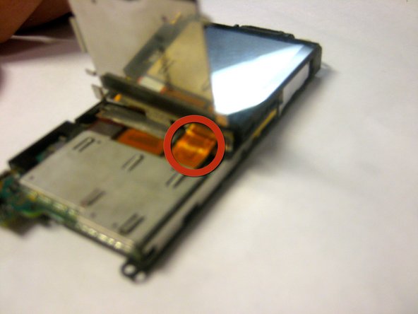

  12. Sony Ericsson W350a Screen Replacement, Screen: crwdns2935265:012crwdnd2935265:01crwdnd2935265:03crwdne2935265:0 Sony Ericsson W350a Screen Replacement, Screen: crwdns2935265:012crwdnd2935265:02crwdnd2935265:03crwdne2935265:0 Sony Ericsson W350a Screen Replacement, Screen: crwdns2935265:012crwdnd2935265:03crwdnd2935265:03crwdne2935265:0
    • After removing the keypad, gently pry apart the screen from the frame of the phone using your fingers and thumbs on opposite sides as shown.
    • Even though the screen is detached from the frame, it will still be electronically connected in a similar fashion as the keypad. This connection is shown in the second picture. To sever this connection, gently pull the wire tape until the male member pops out of its counterpart of the phone.
    • Once the screen and keypad are removed, the assembly of the phone should be as shown in the third picture.
