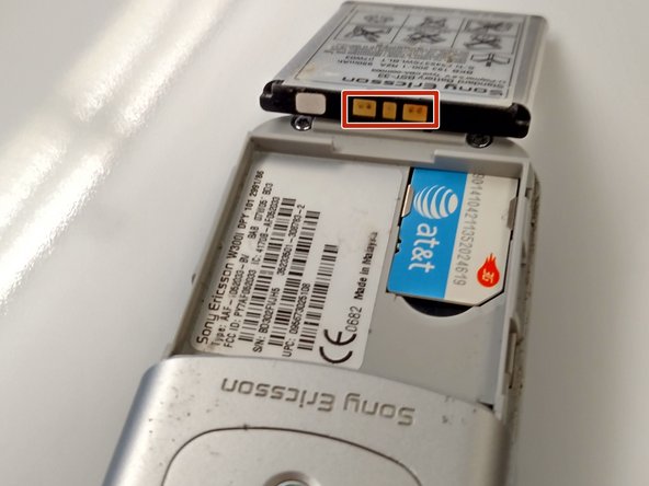

    • Using your fingers, lift the end of the battery up and then pry the battery from the phone base.
    • During reassembly you must reinsert the battery so the gold markings are at the top of the battery.

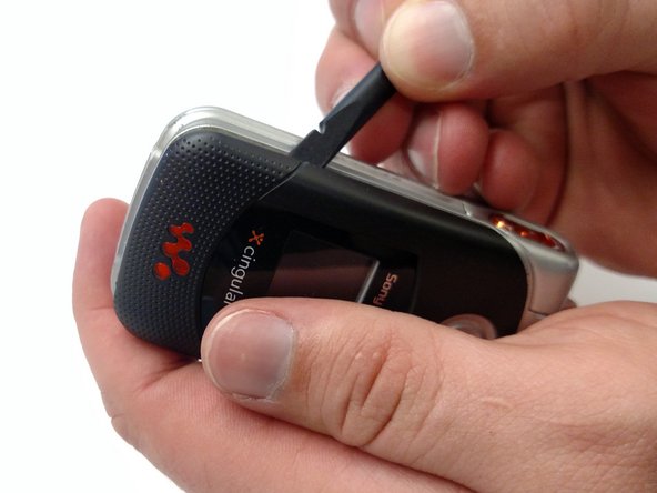

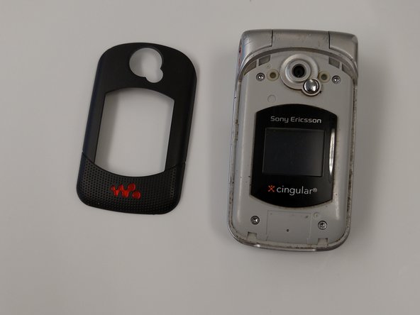

    • Remove the front plate off the phone with a plastic opening tool to gain access to the screws beneath.
    • Use the point indicated on the photo as a good prying point.
    • Use a moderate amount of force.
    • Be aware of the sharp edges of the prying tool.
  5. Sony Ericsson W300i Main Screen Replacement: crwdns2935265:05crwdnd2935265:01crwdnd2935265:02crwdne2935265:0 Sony Ericsson W300i Main Screen Replacement: crwdns2935265:05crwdnd2935265:02crwdnd2935265:02crwdne2935265:0

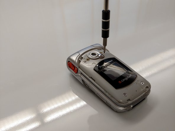

    • Use the T6 Torx screwdriver to remove the four screws.
    • Place screws in a safe location to avoid losing them.

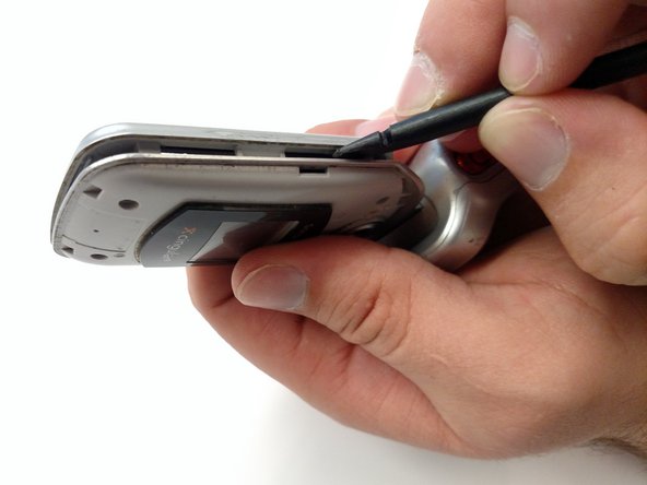

    • Use a plastic opening tool to separate the screen cover from the top half of the phone.
    • Slide the corner of the opening tool along the side of the phone toward the bottom corner.
    • With the phone screen facing away from you, press into the screen crevice at an angle so that the tool pushes away towards the main screen.
    • Once the seal has been broken, tug the cover away.

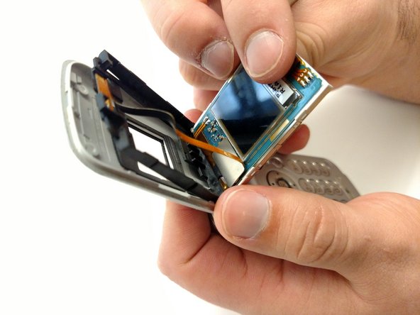

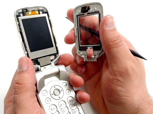

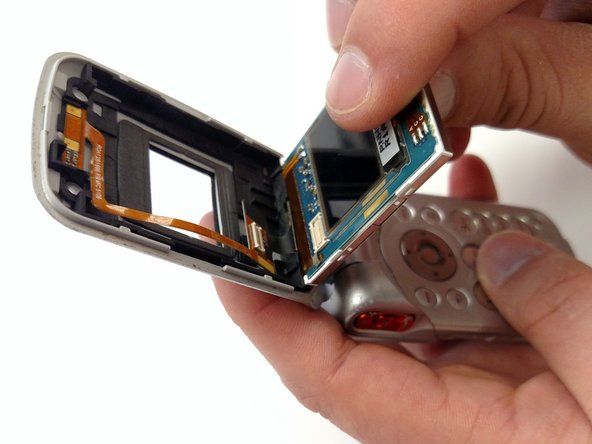

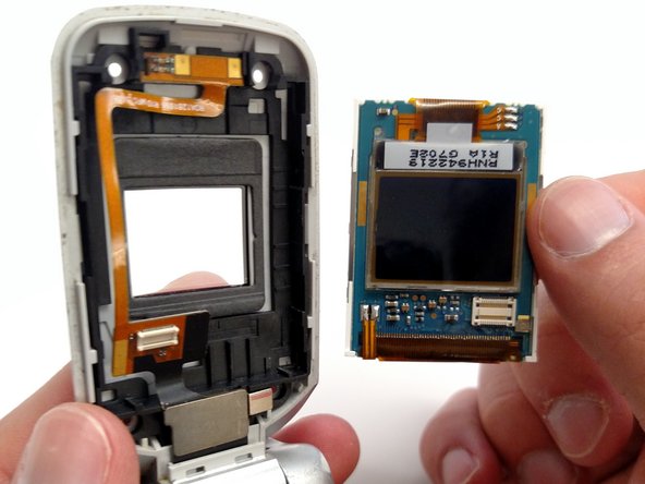

    • Use your fingers to pry the plug end of the orange ribbon cable away from the screen.
    • Remove screen.
  8. Sony Ericsson W300i Main Screen Replacement: crwdns2935265:08crwdnd2935265:01crwdnd2935265:02crwdne2935265:0 Sony Ericsson W300i Main Screen Replacement: crwdns2935265:08crwdnd2935265:02crwdnd2935265:02crwdne2935265:0
    • Using the new screen, reattach the plug end of the orange ribbon cable.
    • Push new screen into the phone.
