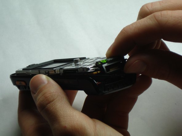

  3. Sony Ericsson W200i Speaker Replacement, Front Case: crwdns2935265:03crwdnd2935265:01crwdnd2935265:03crwdne2935265:0 Sony Ericsson W200i Speaker Replacement, Front Case: crwdns2935265:03crwdnd2935265:02crwdnd2935265:03crwdne2935265:0 Sony Ericsson W200i Speaker Replacement, Front Case: crwdns2935265:03crwdnd2935265:03crwdnd2935265:03crwdne2935265:0
    • Insert the plastic opening tool in between the front case and the back case.
    • Apply downward pressure to make the case lift upwards, thus popping the front case off.
    • Use caution when removing the front case. It may seem stuck but just ease it out.

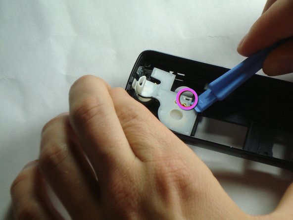

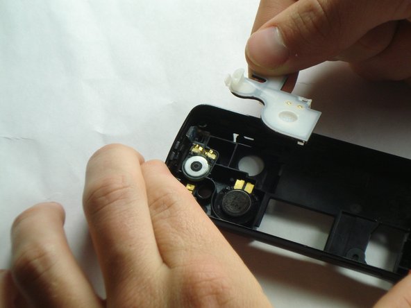

    • Pull back on the indicated tab of the white plastic cover to unhook it from the top of the phone.
    • Using the plastic opening tool, undo the indicated clip on the bottom of the white plastic cover.
    • Remove the white plastic cover.

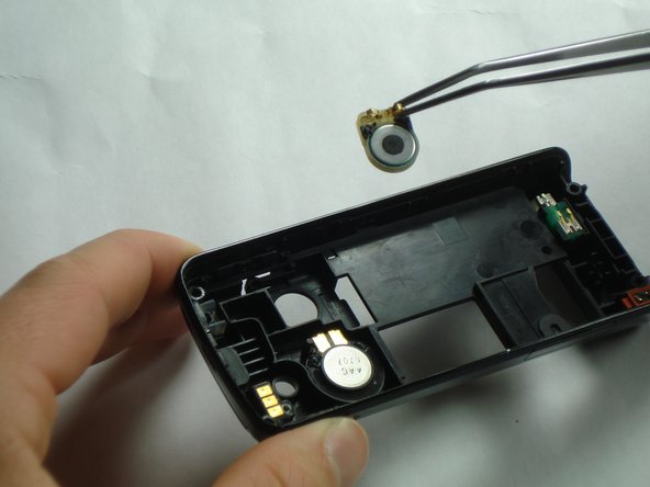

  7. Sony Ericsson W200i Speaker Replacement, Speaker: crwdns2935265:07crwdnd2935265:01crwdnd2935265:02crwdne2935265:0 Sony Ericsson W200i Speaker Replacement, Speaker: crwdns2935265:07crwdnd2935265:02crwdnd2935265:02crwdne2935265:0
    • Remove the speaker by pulling it up and out of place with the tweezers.
