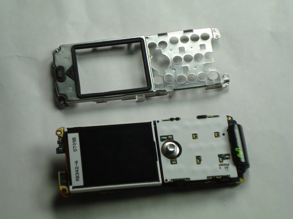

  4. Sony Ericsson W200i LCD Screen Replacement, Core: crwdns2935265:04crwdnd2935265:01crwdnd2935265:02crwdne2935265:0 Sony Ericsson W200i LCD Screen Replacement, Core: crwdns2935265:04crwdnd2935265:02crwdnd2935265:02crwdne2935265:0
    • Remove the 4 screws in the corners of the front of the phone using a T6 screwdriver.
    • Note that the top 2 screws are silver and the bottom 2 screws are black.
  5. Sony Ericsson W200i LCD Screen Replacement: crwdns2935265:05crwdnd2935265:01crwdnd2935265:03crwdne2935265:0 Sony Ericsson W200i LCD Screen Replacement: crwdns2935265:05crwdnd2935265:02crwdnd2935265:03crwdne2935265:0 Sony Ericsson W200i LCD Screen Replacement: crwdns2935265:05crwdnd2935265:03crwdnd2935265:03crwdne2935265:0
    • There is a black tab in the top left corner holding the core in place.
    • Remove the core by pulling straight up to prevent breaking the tab.

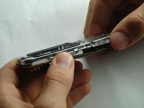

  6. Sony Ericsson W200i LCD Screen Replacement, LCD Screen: crwdns2935265:06crwdnd2935265:01crwdnd2935265:03crwdne2935265:0 Sony Ericsson W200i LCD Screen Replacement, LCD Screen: crwdns2935265:06crwdnd2935265:02crwdnd2935265:03crwdne2935265:0 Sony Ericsson W200i LCD Screen Replacement, LCD Screen: crwdns2935265:06crwdnd2935265:03crwdnd2935265:03crwdne2935265:0
    • Undo the metal clip on each side of the core using the plastic opening tool.
    • Do not bend clips past 2mm or they could break.

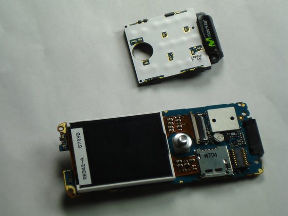

  7. Sony Ericsson W200i LCD Screen Replacement: crwdns2935265:07crwdnd2935265:01crwdnd2935265:03crwdne2935265:0 Sony Ericsson W200i LCD Screen Replacement: crwdns2935265:07crwdnd2935265:02crwdnd2935265:03crwdne2935265:0 Sony Ericsson W200i LCD Screen Replacement: crwdns2935265:07crwdnd2935265:03crwdnd2935265:03crwdne2935265:0
    • Gently pull the white keyboard and charging port away from the motherboard and off the phone.

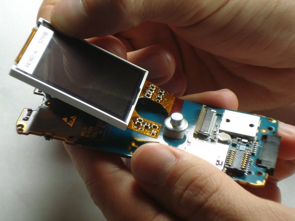

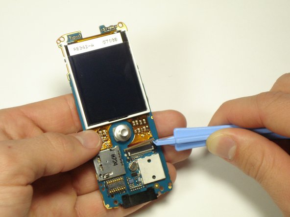

  8. Sony Ericsson W200i LCD Screen Replacement: crwdns2935265:08crwdnd2935265:01crwdnd2935265:03crwdne2935265:0 Sony Ericsson W200i LCD Screen Replacement: crwdns2935265:08crwdnd2935265:02crwdnd2935265:03crwdne2935265:0 Sony Ericsson W200i LCD Screen Replacement: crwdns2935265:08crwdnd2935265:03crwdnd2935265:03crwdne2935265:0
    • Undo the grey clip that holds the LCD ribbon in place by loosening one side of the clip with the plastic opening tool, then gently separate the other side of the clip from the holder.
    • The copper end of the ribbon should slide out of the housing as you pull the LCD up and away from the motherboard.
    • Using too much force may bend the copper ribbon.
