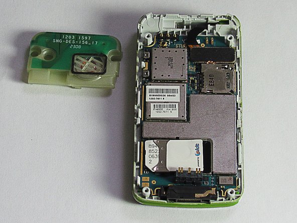

    • There are eight snap hooks located around the outer case. Carefully snap these to remove the outer case.
  6. Sony Ericsson TM506 Sound Box Replacement, Sound Box: crwdns2935265:06crwdnd2935265:01crwdnd2935265:03crwdne2935265:0 Sony Ericsson TM506 Sound Box Replacement, Sound Box: crwdns2935265:06crwdnd2935265:02crwdnd2935265:03crwdne2935265:0 Sony Ericsson TM506 Sound Box Replacement, Sound Box: crwdns2935265:06crwdnd2935265:03crwdnd2935265:03crwdne2935265:0

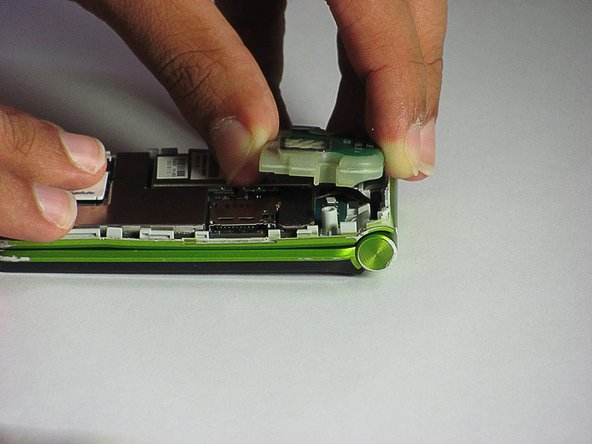

    • The sound box is attached to the case by two snap hooks.
    • Lift the sound box up to remove it from the case.
