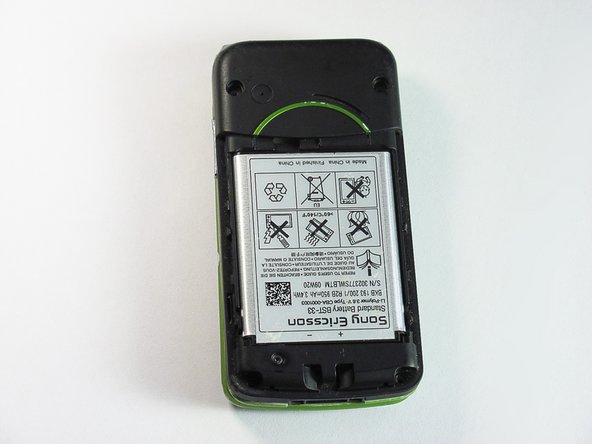

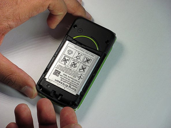

    • Firmly hold the phone between your fingers with your thumb on the battery cover.
    • Push down with your thumb until the battery cover comes off.

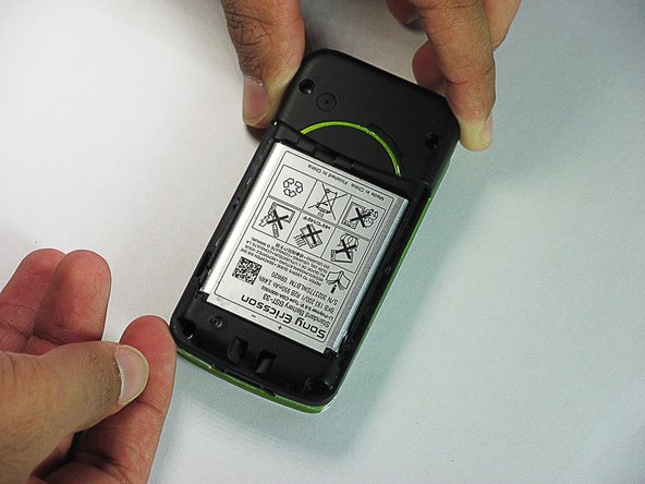

  2. Sony Ericsson TM506 Sim Card Replacement, Back Case: crwdns2935265:02crwdnd2935265:01crwdnd2935265:03crwdne2935265:0 Sony Ericsson TM506 Sim Card Replacement, Back Case: crwdns2935265:02crwdnd2935265:02crwdnd2935265:03crwdne2935265:0 Sony Ericsson TM506 Sim Card Replacement, Back Case: crwdns2935265:02crwdnd2935265:03crwdnd2935265:03crwdne2935265:0
    • Unscrew the bottom two 5.4mm screws with a Torx T6 screwdriver.

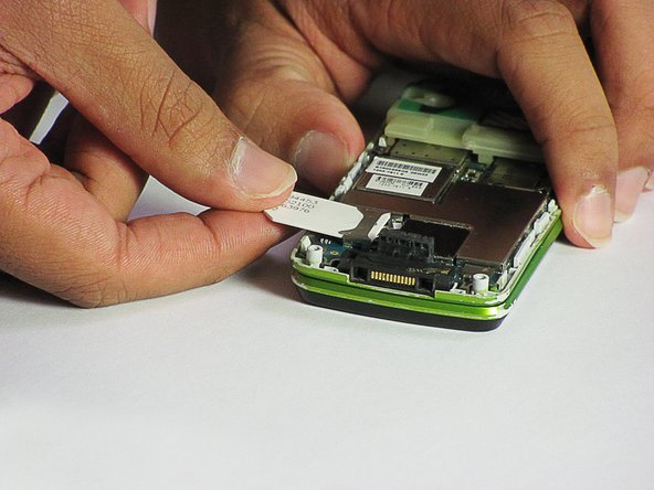

  6. Sony Ericsson TM506 Sim Card Replacement, Sim Card: crwdns2935265:06crwdnd2935265:01crwdnd2935265:02crwdne2935265:0 Sony Ericsson TM506 Sim Card Replacement, Sim Card: crwdns2935265:06crwdnd2935265:02crwdnd2935265:02crwdne2935265:0
    • The Sim card can simply be pulled out through the opening.
