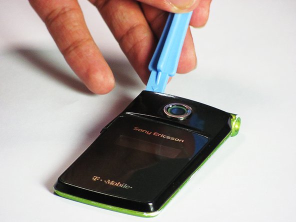

  5. Sony Ericsson TM506 Screen Replacement: crwdns2935265:05crwdnd2935265:01crwdnd2935265:03crwdne2935265:0 Sony Ericsson TM506 Screen Replacement: crwdns2935265:05crwdnd2935265:02crwdnd2935265:03crwdne2935265:0 Sony Ericsson TM506 Screen Replacement: crwdns2935265:05crwdnd2935265:03crwdnd2935265:03crwdne2935265:0
    • There are eight snap hooks located around the outer case. Carefully snap these to remove the outer case.

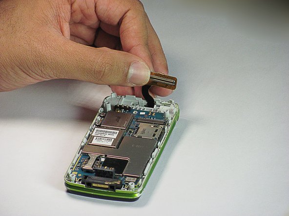

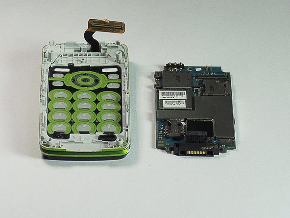

  7. Sony Ericsson TM506 Screen Replacement, Motherboard: crwdns2935265:07crwdnd2935265:01crwdnd2935265:02crwdne2935265:0 Sony Ericsson TM506 Screen Replacement, Motherboard: crwdns2935265:07crwdnd2935265:02crwdnd2935265:02crwdne2935265:0
    • Locate the 80-pin connector.
    • Carefully, lift up on the connector to separate it from the board.

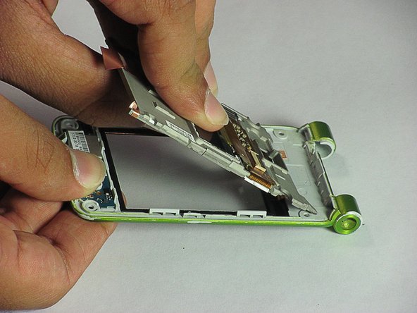

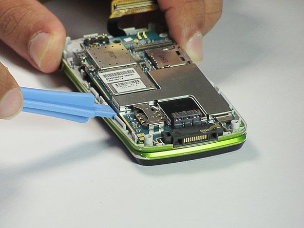

  8. Sony Ericsson TM506 Screen Replacement: crwdns2935265:08crwdnd2935265:01crwdnd2935265:03crwdne2935265:0 Sony Ericsson TM506 Screen Replacement: crwdns2935265:08crwdnd2935265:02crwdnd2935265:03crwdne2935265:0 Sony Ericsson TM506 Screen Replacement: crwdns2935265:08crwdnd2935265:03crwdnd2935265:03crwdne2935265:0
    • There are two snap hooks that attach the motherboard to the case.
    • Using a plastic opening tool, carefully lift up on the motherboard to detach it.
    • The motherboard is extremely fragile. Try to be forceful yet delicate in the removal because it will not come off easily.

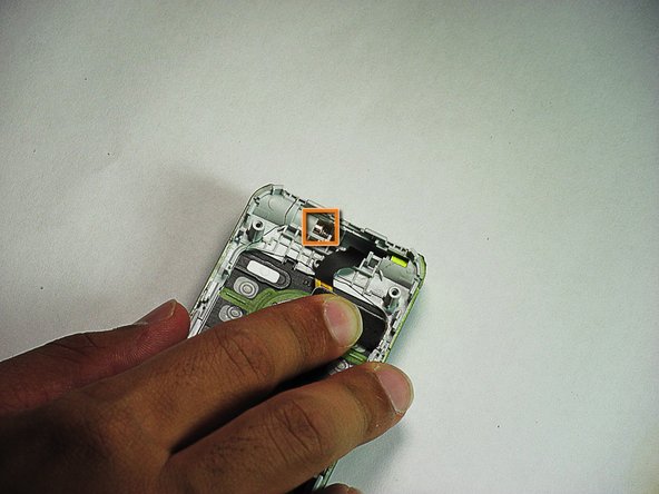

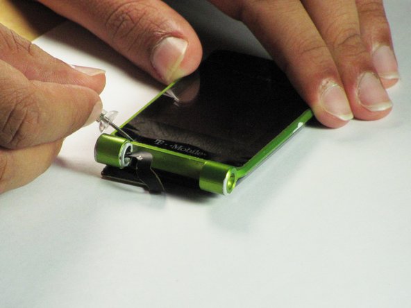

  9. Sony Ericsson TM506 Screen Replacement, Speaker, GPS, and Camera: crwdns2935265:09crwdnd2935265:01crwdnd2935265:02crwdne2935265:0 Sony Ericsson TM506 Screen Replacement, Speaker, GPS, and Camera: crwdns2935265:09crwdnd2935265:02crwdnd2935265:02crwdne2935265:0

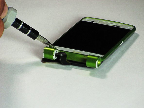

    • Use tweezers to push the hinge stopper in until it can no longer be moved.
    • The hinge stopper should be about 5.5mm in.

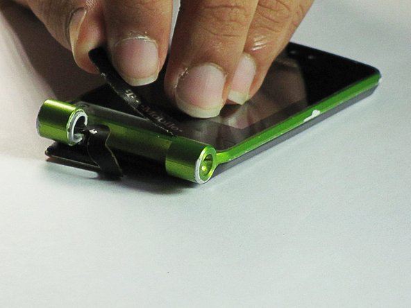

  10. Sony Ericsson TM506 Screen Replacement: crwdns2935265:010crwdnd2935265:01crwdnd2935265:02crwdne2935265:0 Sony Ericsson TM506 Screen Replacement: crwdns2935265:010crwdnd2935265:02crwdnd2935265:02crwdne2935265:0
    • Separate the bottom and top half of the phone from the hinge they are connected by.
    • Don't completely pull apart the two pieces or you will damage the ribbon.
  11. Sony Ericsson TM506 Screen Replacement: crwdns2935265:011crwdnd2935265:01crwdnd2935265:01crwdne2935265:0
    • Pull the ribbon through the opening in the hinge to completely separate the upper and lower halves of the phone.

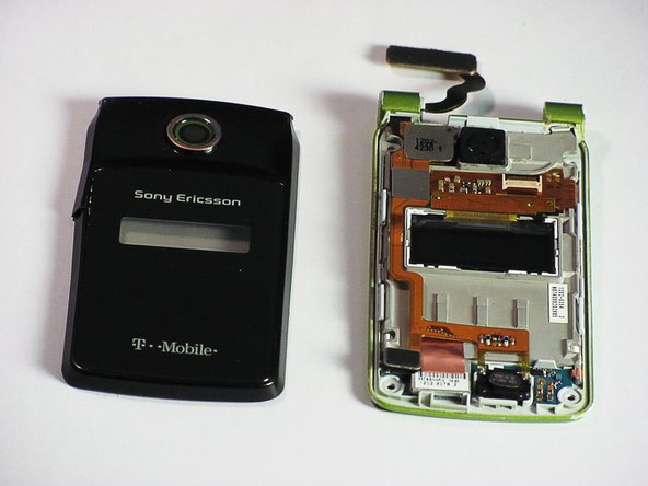

  14. Sony Ericsson TM506 Screen Replacement: crwdns2935265:014crwdnd2935265:01crwdnd2935265:03crwdne2935265:0 Sony Ericsson TM506 Screen Replacement: crwdns2935265:014crwdnd2935265:02crwdnd2935265:03crwdne2935265:0 Sony Ericsson TM506 Screen Replacement: crwdns2935265:014crwdnd2935265:03crwdnd2935265:03crwdne2935265:0
    • Use a plastic opening tool in the indicated location and apply pressure until the case hook is detached. Then lift the case up until the two pieces are detached.

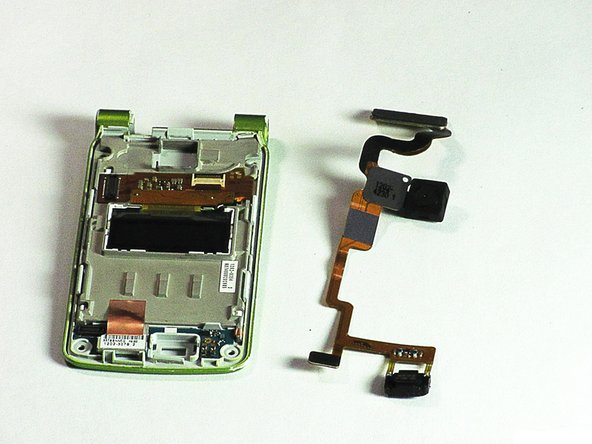

  15. Sony Ericsson TM506 Screen Replacement: crwdns2935265:015crwdnd2935265:01crwdnd2935265:03crwdne2935265:0 Sony Ericsson TM506 Screen Replacement: crwdns2935265:015crwdnd2935265:02crwdnd2935265:03crwdne2935265:0 Sony Ericsson TM506 Screen Replacement: crwdns2935265:015crwdnd2935265:03crwdnd2935265:03crwdne2935265:0

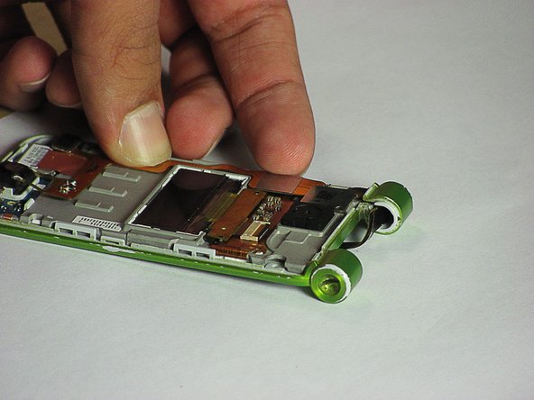

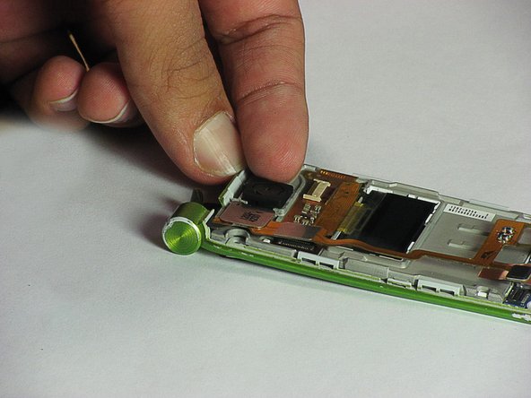

    • Use a paperclip to detach the speaker from the case.
    • Detach the GPS from the case by carefully lifting it up from the case.
    • Detach the camera with your hands or by using a paperclip similar to the way the speaker was removed.
  16. Sony Ericsson TM506 Screen Replacement: crwdns2935265:016crwdnd2935265:01crwdnd2935265:02crwdne2935265:0 Sony Ericsson TM506 Screen Replacement: crwdns2935265:016crwdnd2935265:02crwdnd2935265:02crwdne2935265:0
    • Once the three components are detached, removing the ribbon is possible.
    • Simply, move the ribbon to the right and it will be completely detached from the case.

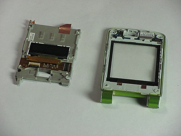

  17. Sony Ericsson TM506 Screen Replacement, Screen: crwdns2935265:017crwdnd2935265:01crwdnd2935265:03crwdne2935265:0 Sony Ericsson TM506 Screen Replacement, Screen: crwdns2935265:017crwdnd2935265:02crwdnd2935265:03crwdne2935265:0 Sony Ericsson TM506 Screen Replacement, Screen: crwdns2935265:017crwdnd2935265:03crwdnd2935265:03crwdne2935265:0
    • Pull apart the screen and the case at one end. Then slide the screen out to completely detach them.
