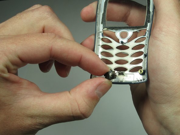

  5. Sony Ericsson T68i Vibration Motor Replacement, Vibration Motor: crwdns2935265:05crwdnd2935265:01crwdnd2935265:02crwdne2935265:0 Sony Ericsson T68i Vibration Motor Replacement, Vibration Motor: crwdns2935265:05crwdnd2935265:02crwdnd2935265:02crwdne2935265:0
    • Remove the vibration motor visible in the front housing.
