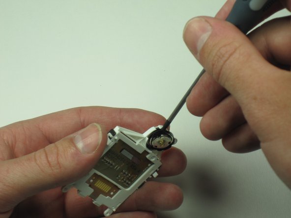

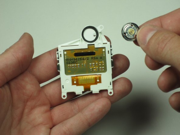

  8. Sony Ericsson T68i Speaker Replacement, Speaker: crwdns2935265:08crwdnd2935265:01crwdnd2935265:03crwdne2935265:0 Sony Ericsson T68i Speaker Replacement, Speaker: crwdns2935265:08crwdnd2935265:02crwdnd2935265:03crwdne2935265:0 Sony Ericsson T68i Speaker Replacement, Speaker: crwdns2935265:08crwdnd2935265:03crwdnd2935265:03crwdne2935265:0
    • Gently pry it out the speaker located in the screen housing with a small screwdriver or similar tool.
