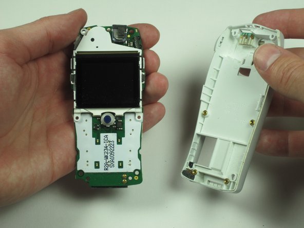

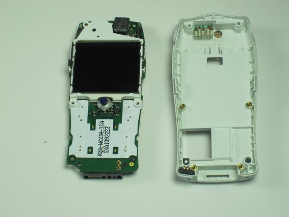

  5. Sony Ericsson T68i Microphone Replacement, Microphone: crwdns2935265:05crwdnd2935265:01crwdnd2935265:03crwdne2935265:0 Sony Ericsson T68i Microphone Replacement, Microphone: crwdns2935265:05crwdnd2935265:02crwdnd2935265:03crwdne2935265:0 Sony Ericsson T68i Microphone Replacement, Microphone: crwdns2935265:05crwdnd2935265:03crwdnd2935265:03crwdne2935265:0
    • Next remove the circuit board and screen from the device.
    • Use your T6 to remove the 4 screws holding the cover on.
  6. Sony Ericsson T68i Microphone Replacement: crwdns2935265:06crwdnd2935265:01crwdnd2935265:03crwdne2935265:0 Sony Ericsson T68i Microphone Replacement: crwdns2935265:06crwdnd2935265:02crwdnd2935265:03crwdne2935265:0 Sony Ericsson T68i Microphone Replacement: crwdns2935265:06crwdnd2935265:03crwdnd2935265:03crwdne2935265:0
    • The board and screen should just pop out at this point.

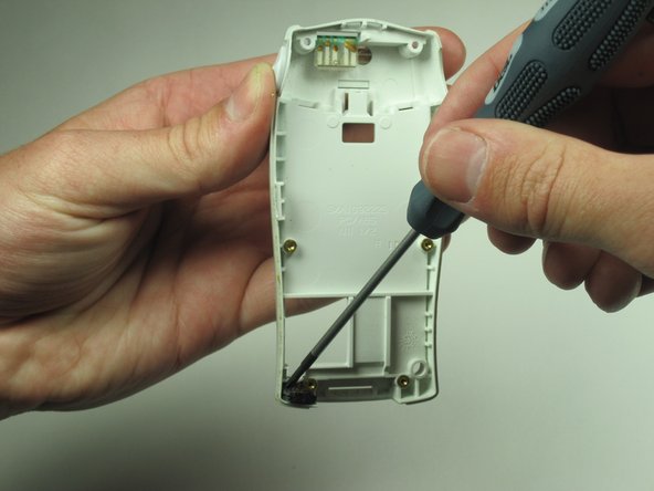

  7. Sony Ericsson T68i Microphone Replacement: crwdns2935265:07crwdnd2935265:01crwdnd2935265:02crwdne2935265:0 Sony Ericsson T68i Microphone Replacement: crwdns2935265:07crwdnd2935265:02crwdnd2935265:02crwdne2935265:0
    • The microphone at the bottom of the rear housing can be levered out using a small screwdriver or any similar tool.
