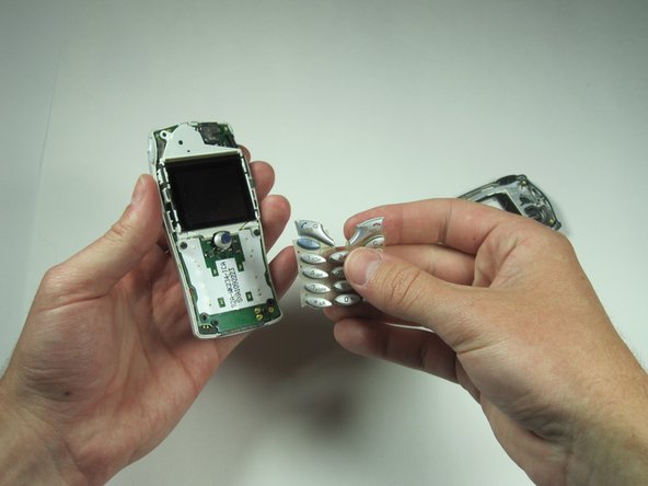

    • Remove the battery from the back.

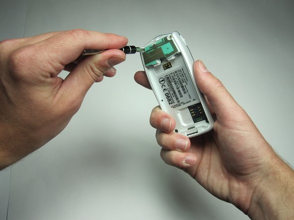

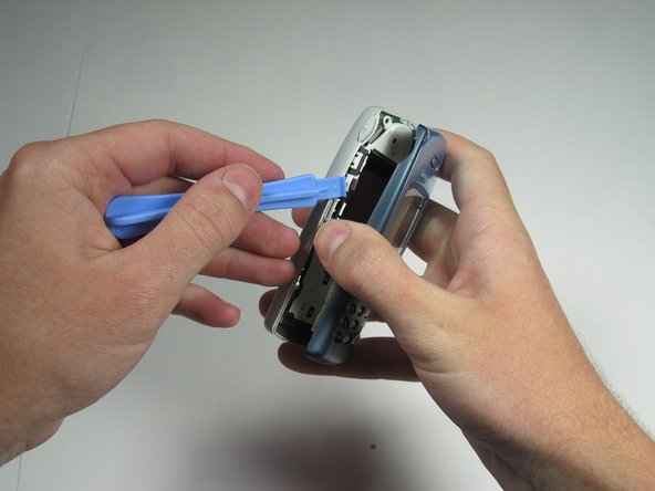

    • Pry off the plastic cover from the top with a thin plastic shim, then remove it from the two bottom clips.
    • Do not bend it too far down, or else you risk breaking the two bottom clips.

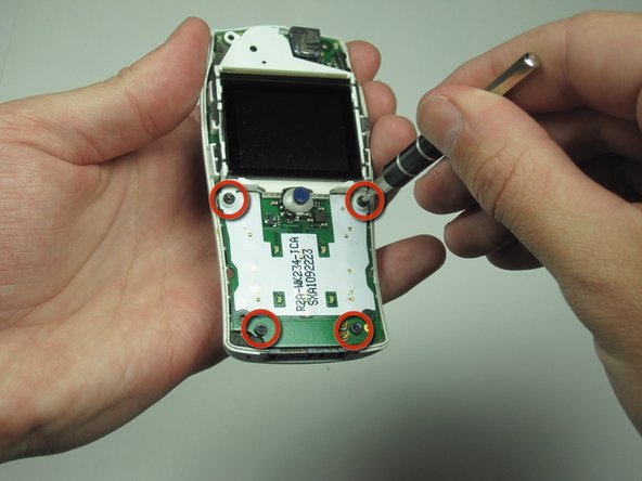

  3. Sony Ericsson T68i Logic Board Replacement: crwdns2935265:03crwdnd2935265:01crwdnd2935265:03crwdne2935265:0 Sony Ericsson T68i Logic Board Replacement: crwdns2935265:03crwdnd2935265:02crwdnd2935265:03crwdne2935265:0 Sony Ericsson T68i Logic Board Replacement: crwdns2935265:03crwdnd2935265:03crwdnd2935265:03crwdne2935265:0
    • Unscrew all four Torx T6 screws.
    • Keep in a safe place.

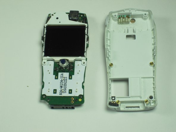

  4. Sony Ericsson T68i Logic Board Replacement: crwdns2935265:04crwdnd2935265:01crwdnd2935265:03crwdne2935265:0 Sony Ericsson T68i Logic Board Replacement: crwdns2935265:04crwdnd2935265:02crwdnd2935265:03crwdne2935265:0 Sony Ericsson T68i Logic Board Replacement: crwdns2935265:04crwdnd2935265:03crwdnd2935265:03crwdne2935265:0
    • After removing the screws, the two halves will separate. If not, then pry them gently apart.

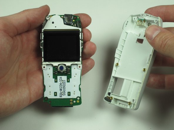

  5. Sony Ericsson T68i Logic Board Replacement, Screen: crwdns2935265:05crwdnd2935265:01crwdnd2935265:03crwdne2935265:0 Sony Ericsson T68i Logic Board Replacement, Screen: crwdns2935265:05crwdnd2935265:02crwdnd2935265:03crwdne2935265:0 Sony Ericsson T68i Logic Board Replacement, Screen: crwdns2935265:05crwdnd2935265:03crwdnd2935265:03crwdne2935265:0

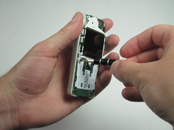

    • Remove the circuit board and screen from the device.
    • Use your T6 to remove the 4 screws.

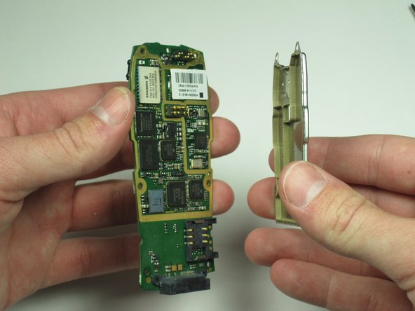

  6. Sony Ericsson T68i Logic Board Replacement: crwdns2935265:06crwdnd2935265:01crwdnd2935265:03crwdne2935265:0 Sony Ericsson T68i Logic Board Replacement: crwdns2935265:06crwdnd2935265:02crwdnd2935265:03crwdne2935265:0 Sony Ericsson T68i Logic Board Replacement: crwdns2935265:06crwdnd2935265:03crwdnd2935265:03crwdne2935265:0
    • Remove the board and screen.

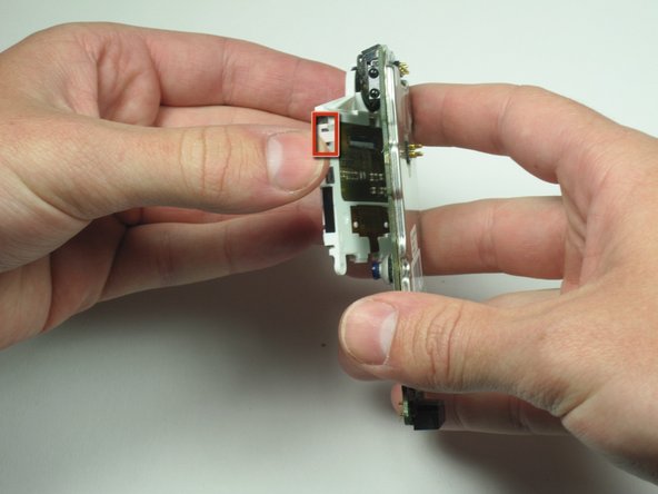

  7. Sony Ericsson T68i Logic Board Replacement: crwdns2935265:07crwdnd2935265:01crwdnd2935265:03crwdne2935265:0 Sony Ericsson T68i Logic Board Replacement: crwdns2935265:07crwdnd2935265:02crwdnd2935265:03crwdne2935265:0 Sony Ericsson T68i Logic Board Replacement: crwdns2935265:07crwdnd2935265:03crwdnd2935265:03crwdne2935265:0
    • Carefully remove the plastic clips holding the screen on the board.

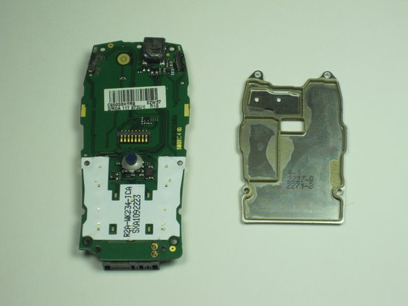

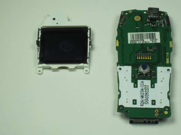

  8. Sony Ericsson T68i Logic Board Replacement, Logic Board: crwdns2935265:08crwdnd2935265:01crwdnd2935265:03crwdne2935265:0 Sony Ericsson T68i Logic Board Replacement, Logic Board: crwdns2935265:08crwdnd2935265:02crwdnd2935265:03crwdne2935265:0 Sony Ericsson T68i Logic Board Replacement, Logic Board: crwdns2935265:08crwdnd2935265:03crwdnd2935265:03crwdne2935265:0
    • Remove the plate protecting the more delicate processing parts from the logic board.
