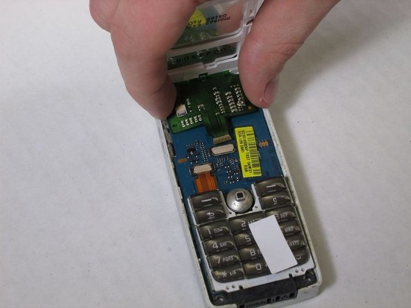

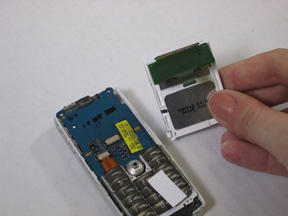

  9. Sony Ericsson QuickShare T630 Screen Replacement: crwdns2935265:09crwdnd2935265:01crwdnd2935265:03crwdne2935265:0 Sony Ericsson QuickShare T630 Screen Replacement: crwdns2935265:09crwdnd2935265:02crwdnd2935265:03crwdne2935265:0 Sony Ericsson QuickShare T630 Screen Replacement: crwdns2935265:09crwdnd2935265:03crwdnd2935265:03crwdne2935265:0
    • This step is NOT required for joystick maintenance or keypad maintenance and replacement! Continue on to step 10 if you are attempting to achieve either of these goals.
    • Slowly lift the screen to reveal the green circuit ribbon connecting the screen to the phone.
    • Gently pull the ribbon from the circuit.
    • Remove the now disconnected screen.

  11. Sony Ericsson QuickShare T630 Screen Replacement, Sony Ericsson QuickShare T630 Screen: crwdns2935265:011crwdnd2935265:01crwdnd2935265:03crwdne2935265:0 Sony Ericsson QuickShare T630 Screen Replacement, Sony Ericsson QuickShare T630 Screen: crwdns2935265:011crwdnd2935265:02crwdnd2935265:03crwdne2935265:0 Sony Ericsson QuickShare T630 Screen Replacement, Sony Ericsson QuickShare T630 Screen: crwdns2935265:011crwdnd2935265:03crwdnd2935265:03crwdne2935265:0
    • To place a new screen, slide the green ribbon connector into the ribbon clamp that the defective screen was pulled from.
