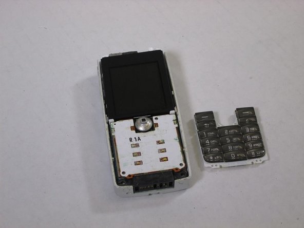

    • Remove the keyboard by slowly pulling it away from the circuit board.
    • There are no direct connections between the keyboard and phone.
    • These are all of the parts covered in this disassembly that make up the Sony Ericsson QuickShare T630.
  11. Sony Ericsson QuickShare T630 Keypad Maintenance and Replacement, Sony Ericsson QuickShare T630 Keypad Maintenance and Replacement: crwdns2935265:011crwdnd2935265:01crwdnd2935265:02crwdne2935265:0 Sony Ericsson QuickShare T630 Keypad Maintenance and Replacement, Sony Ericsson QuickShare T630 Keypad Maintenance and Replacement: crwdns2935265:011crwdnd2935265:02crwdnd2935265:02crwdne2935265:0
    • After wetting the cotton swab with the rubbing alcohol, rub the keypad with the swab until the buttons are clean.
    • Dry out the keypad by placing it on a flat surface before reassembling the device.
