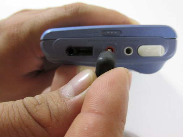

    • Another problem involves the stereo jack of the microphone being inserted into the wrong output of the external device.
  3. Sony ECM-MS907 Volume issue troubleshooting: crwdns2935265:03crwdnd2935265:01crwdnd2935265:02crwdne2935265:0 Sony ECM-MS907 Volume issue troubleshooting: crwdns2935265:03crwdnd2935265:02crwdnd2935265:02crwdne2935265:0
    • In this particular external device, the Sony MiniDisc player, the microphone stereo jack can mistakenly be inserted into the laptop, or "white" input.
    • Always remember to insert stereo jack into the microplug, or "red" input.
