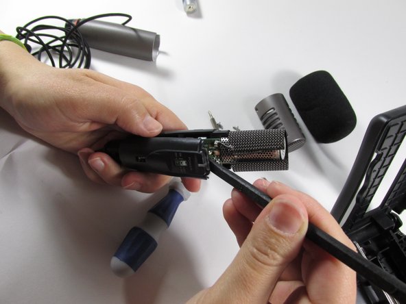

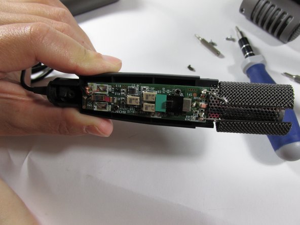

    • Using a Phillips #2 screwdriver, remove the screw directly above the battery.
  5. Sony ECM-MS907 Microphone Disassembly: crwdns2935265:05crwdnd2935265:01crwdnd2935265:01crwdne2935265:0
    • Use a Phillips #0 screwdriver to remove the black screw near the bottom of the microphone.
  6. Sony ECM-MS907 Microphone Disassembly: crwdns2935265:06crwdnd2935265:01crwdnd2935265:03crwdne2935265:0 Sony ECM-MS907 Microphone Disassembly: crwdns2935265:06crwdnd2935265:02crwdnd2935265:03crwdne2935265:0 Sony ECM-MS907 Microphone Disassembly: crwdns2935265:06crwdnd2935265:03crwdnd2935265:03crwdne2935265:0
