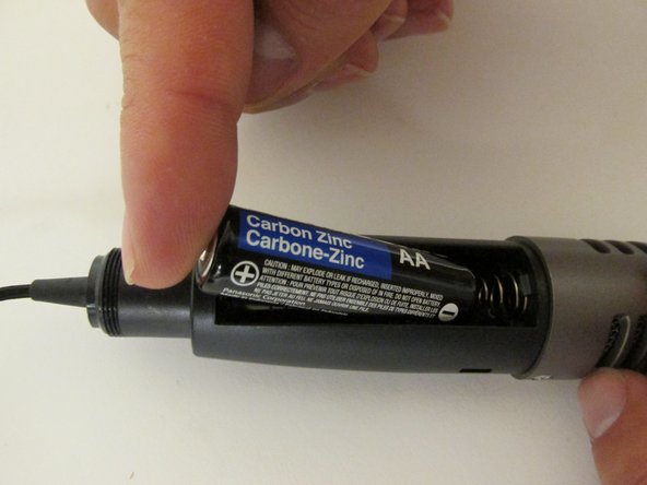

    • Take off the windshield from the top of the microphone and place aside. The bottom part of the microphone is detachable. In a clockwise motion, begin unscrewing the bottom of the microphone from its base.
  2. Sony ECM-MS907 Battery Replacement: crwdns2935265:02crwdnd2935265:01crwdnd2935265:02crwdne2935265:0 Sony ECM-MS907 Battery Replacement: crwdns2935265:02crwdnd2935265:02crwdnd2935265:02crwdne2935265:0
    • Pull off the bottom base of the microphone. The microphone should now be in two pieces. After the bottom base is removed, the battery should now be visible.
  3. Sony ECM-MS907 Battery Replacement: crwdns2935265:03crwdnd2935265:01crwdnd2935265:01crwdne2935265:0
    • To remove the battery, push it upward into the aluminum spring. This will loosen and free the battery.
  4. Sony ECM-MS907 Battery Replacement: crwdns2935265:04crwdnd2935265:01crwdnd2935265:02crwdne2935265:0 Sony ECM-MS907 Battery Replacement: crwdns2935265:04crwdnd2935265:02crwdnd2935265:02crwdne2935265:0
    • Select a new, (AA) battery to insert into the microphone. Match the (+) and (-) sides of the battery to the matching symbols inside the microphone.
