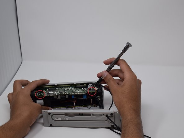

    4. Sony Dream Machine ICF-C717PJ Projector Adjustment: crwdns2935265:04crwdnd2935265:01crwdnd2935265:02crwdne2935265:0 Sony Dream Machine ICF-C717PJ Projector Adjustment: crwdns2935265:04crwdnd2935265:02crwdnd2935265:02crwdne2935265:0
      • Remove screws from motherboard as shown in the photo.
    5. Sony Dream Machine ICF-C717PJ Projector Adjustment: crwdns2935265:05crwdnd2935265:01crwdnd2935265:01crwdne2935265:0
      • Pull motherboard out with your hands.
