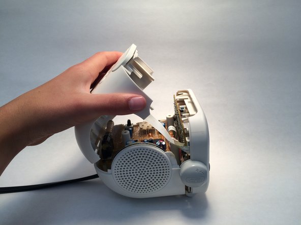

  3. Sony Dream Machine ICF-C180 Speaker Replacement: crwdns2935265:03crwdnd2935265:01crwdnd2935265:02crwdne2935265:0 Sony Dream Machine ICF-C180 Speaker Replacement: crwdns2935265:03crwdnd2935265:02crwdnd2935265:02crwdne2935265:0
    • To open the top casing, pull it upward.
    • Be careful not to yank on the ribbon cable when pulling on the top casing.

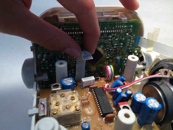

  4. Sony Dream Machine ICF-C180 Speaker Replacement: crwdns2935265:04crwdnd2935265:01crwdnd2935265:02crwdne2935265:0 Sony Dream Machine ICF-C180 Speaker Replacement: crwdns2935265:04crwdnd2935265:02crwdnd2935265:02crwdne2935265:0
    • Pull upward on the blue and white ribbon cables to remove them. This will make it easier to remove the speaker.

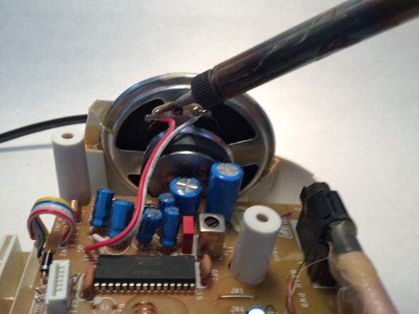

    • Desolder the wires going to the speaker with a soldering iron.

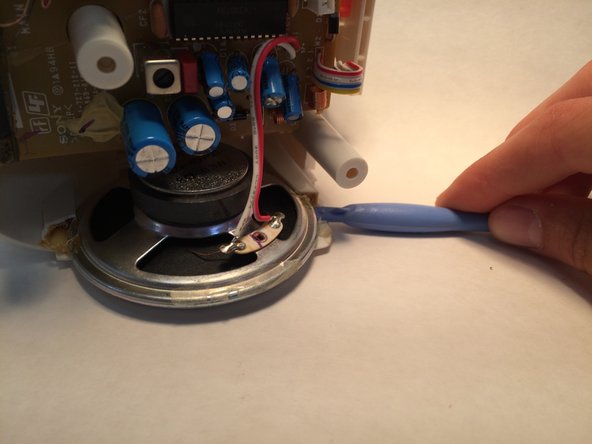

    • Use the plastic opening tool to remove the glue from the speaker.
  7. Sony Dream Machine ICF-C180 Speaker Replacement: crwdns2935265:07crwdnd2935265:01crwdnd2935265:02crwdne2935265:0 Sony Dream Machine ICF-C180 Speaker Replacement: crwdns2935265:07crwdnd2935265:02crwdnd2935265:02crwdne2935265:0

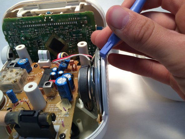

    • Loosen the speaker from the remaining glue with a plastic opening tool.
    • Insert the plastic opening tool into the rail that holds the speaker and push down.

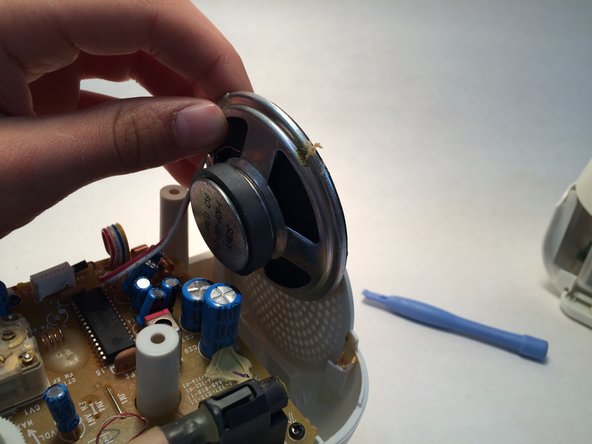

  8. Sony Dream Machine ICF-C180 Speaker Replacement: crwdns2935265:08crwdnd2935265:01crwdnd2935265:02crwdne2935265:0 Sony Dream Machine ICF-C180 Speaker Replacement: crwdns2935265:08crwdnd2935265:02crwdnd2935265:02crwdne2935265:0
    • Pull the speaker upward to remove it.
