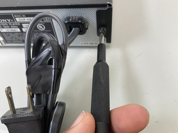

  4. Sony DVP-NS325 Power Supply Board Replacement, Power Cable: crwdns2935265:04crwdnd2935265:01crwdnd2935265:02crwdne2935265:0 Sony DVP-NS325 Power Supply Board Replacement, Power Cable: crwdns2935265:04crwdnd2935265:02crwdnd2935265:02crwdne2935265:0
    • Unscrew all screws using a Phillips screwdriver removing the outer case to access the power cable.

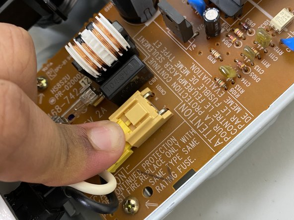

  5. Sony DVP-NS325 Power Supply Board Replacement: crwdns2935265:05crwdnd2935265:01crwdnd2935265:02crwdne2935265:0 Sony DVP-NS325 Power Supply Board Replacement: crwdns2935265:05crwdnd2935265:02crwdnd2935265:02crwdne2935265:0
    • Using a finger, press down on the clip to remove the connector for the cable.

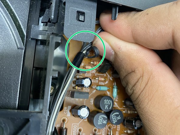

  8. Sony DVP-NS325 Power Supply Board Replacement, Power Supply Board: crwdns2935265:08crwdnd2935265:01crwdnd2935265:02crwdne2935265:0 Sony DVP-NS325 Power Supply Board Replacement, Power Supply Board: crwdns2935265:08crwdnd2935265:02crwdnd2935265:02crwdne2935265:0
    • Remove the wire connected to the motherboard by pulling the wire upwards.
    • Move the black holder piece out of the way in order to fully remove the wire from the area.
