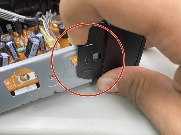

  3. Sony DVP-NS325 Optical Drive Replacement: crwdns2935265:03crwdnd2935265:01crwdnd2935265:01crwdne2935265:0
    • Use a spudger to separate the case from the chassis.
    • Remove the case.

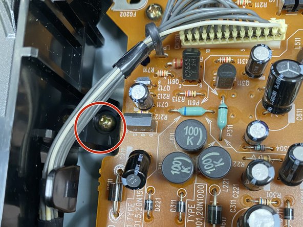

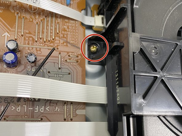

    • The Location of the three screws holding the CD reader in place.
  5. Sony DVP-NS325 Optical Drive Replacement: crwdns2935265:05crwdnd2935265:01crwdnd2935265:01crwdne2935265:0
    • Use a Phillips screwdriver to remove all three screws holding the CD reader in position.
    • Two screws not shown.

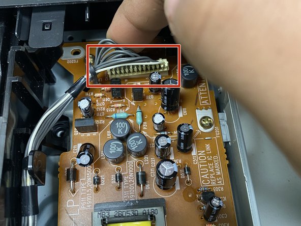

  6. Sony DVP-NS325 Optical Drive Replacement: crwdns2935265:06crwdnd2935265:01crwdnd2935265:02crwdne2935265:0 Sony DVP-NS325 Optical Drive Replacement: crwdns2935265:06crwdnd2935265:02crwdnd2935265:02crwdne2935265:0
    • Disconnect all of the optical drive motherboard connections.

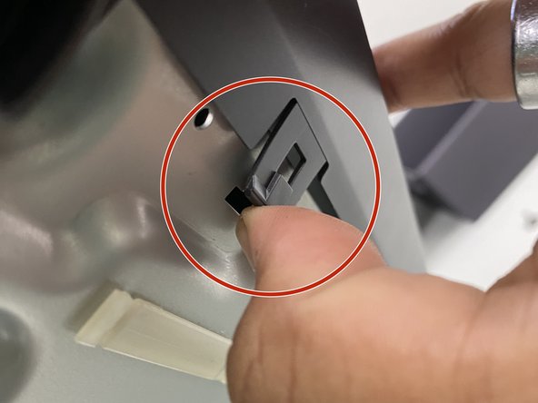

  7. Sony DVP-NS325 Optical Drive Replacement: crwdns2935265:07crwdnd2935265:01crwdnd2935265:03crwdne2935265:0 Sony DVP-NS325 Optical Drive Replacement: crwdns2935265:07crwdnd2935265:02crwdnd2935265:03crwdne2935265:0 Sony DVP-NS325 Optical Drive Replacement: crwdns2935265:07crwdnd2935265:03crwdnd2935265:03crwdne2935265:0
    • Lift the four retention clips holding the face of the DVD player in place.
    • Two clips are not shown, left and bottom right side clips.
