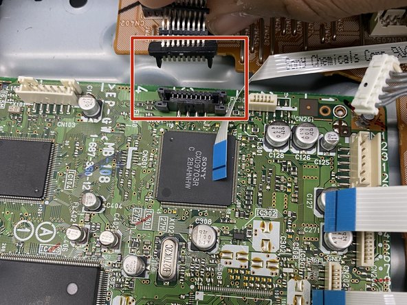

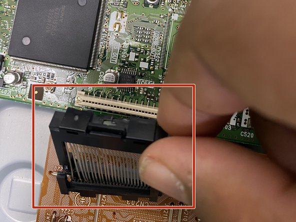

  4. Sony DVP-NS325 Motherboard Replacement, Motherboard: crwdns2935265:04crwdnd2935265:01crwdnd2935265:03crwdne2935265:0 Sony DVP-NS325 Motherboard Replacement, Motherboard: crwdns2935265:04crwdnd2935265:02crwdnd2935265:03crwdne2935265:0 Sony DVP-NS325 Motherboard Replacement, Motherboard: crwdns2935265:04crwdnd2935265:03crwdnd2935265:03crwdne2935265:0
    • Remove all cables that are connected to the motherboard by pulling upwards from the motherboard.
    • Grip as close to the connectors as possible. Avoid pulling on the wires/ribbon cables.
