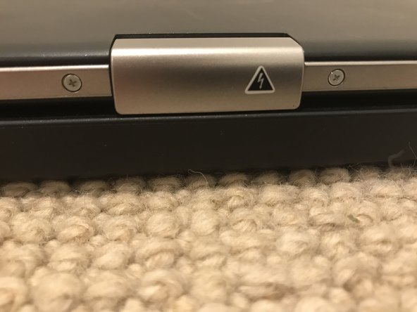

    • I am able to remove these phillips head screw with a PH0 bit.
    • I spot an illegal sticker! These aren't legally binding, but what warranty from 2006 is even valid today anyways?

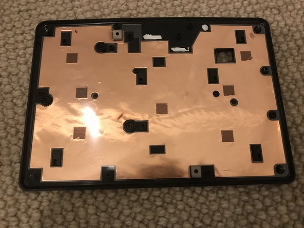

    • Piercing through that reveals another screw!
    • We can now remove the back cover.

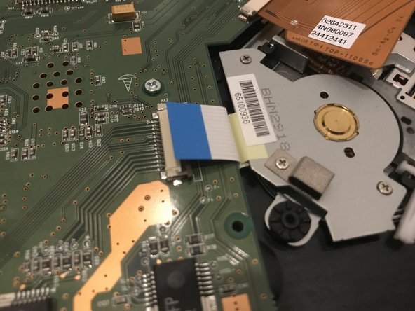

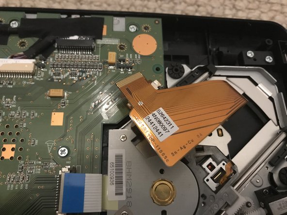

    • I remove these 2 ribbon cables by pulling back on the black plastic piece gently, and then pulling out the cable.
    • First, pull on both sides
    • Then pull out.

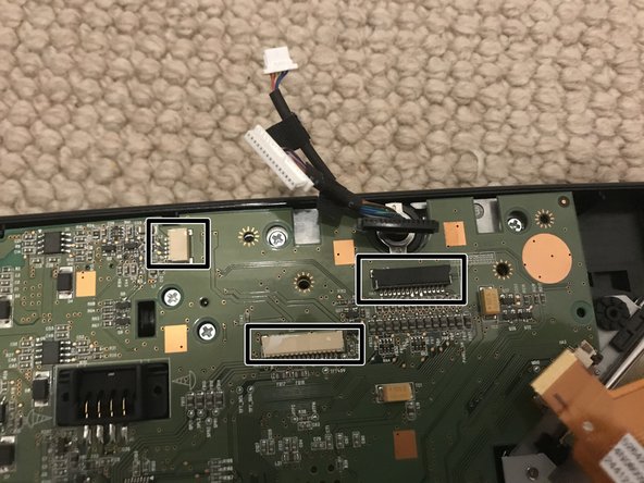

    • Before we remove the motherboard, we have to peel back the tape, and unplug these 3 connectors.
    • Pull them by the plug, NOT the wire.

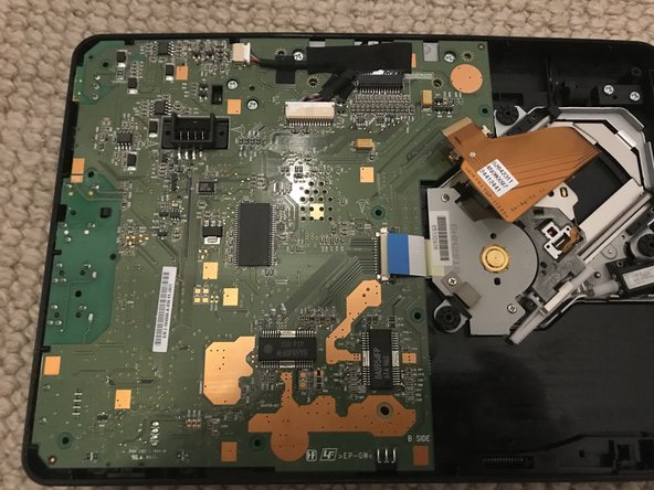

    • Now, we can remove the motherboard.
    • Top of motherboard
    • Power
    • I/O
    • Volume
    • CPU
    • Battery Connector
  9. Sony DVP-FX810 Disassembly: crwdns2935265:09crwdnd2935265:01crwdnd2935265:01crwdne2935265:0
    • Bottom of motherboard
    • Optical Drive Connectors
    • Display Connectors
    • Battery Connector

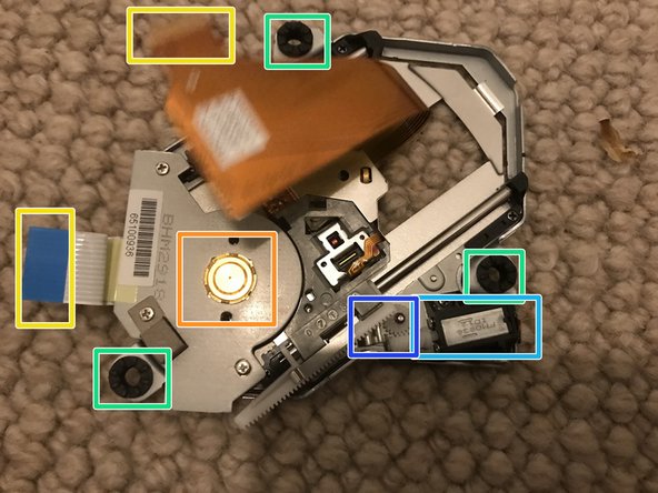

    • The optical drive assembly can just be lifted right off, no screws required!
    • Laser
    • Wheel
    • Connectors
    • Shock absorbers
    • Laser motor
    • Laser motor gears
  11. Sony DVP-FX810 Disassembly: crwdns2935265:011crwdnd2935265:01crwdnd2935265:02crwdne2935265:0 Sony DVP-FX810 Disassembly: crwdns2935265:011crwdnd2935265:02crwdnd2935265:02crwdne2935265:0
