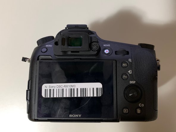

If your Sony DSC-RX10M3 is not displaying accurate pictures, this guide will help you replace the viewfinder, which is the component that you look through when trying to capture a shot. You will need to completely remove the back panel of the camera before proceeding to replace the viewfinder. It is important that you are wary of the ribbon cable in the last step and make sure that you don’t apply too much pressure or it might cause damage. There are a lot of screws in this device, and it’s recommended that you use iFixit’s magnetic project mat to place your screws in.
For this guide, you are not required to remove the side panel in step 6.
    1. Sony DSC-RX10M3 Viewfinder Replacement, Back and Right Panel: crwdns2935265:01crwdnd2935265:01crwdnd2935265:01crwdne2935265:0
      • Remove the twelve 0.7mm Phillips #000 screws from the bottom case.
    2. Sony DSC-RX10M3 Viewfinder Replacement: crwdns2935265:02crwdnd2935265:01crwdnd2935265:02crwdne2935265:0 Sony DSC-RX10M3 Viewfinder Replacement: crwdns2935265:02crwdnd2935265:02crwdnd2935265:02crwdne2935265:0
      • Remove the two 0.7mm screws that secure the right side of the camera.
      • Remove the two 0.7mm screws that secure the left side of the camera, near the Wi-Fi logo and charging port.
    3. Sony DSC-RX10M3 Viewfinder Replacement: crwdns2935265:03crwdnd2935265:01crwdnd2935265:02crwdne2935265:0 Sony DSC-RX10M3 Viewfinder Replacement: crwdns2935265:03crwdnd2935265:02crwdnd2935265:02crwdne2935265:0
      • Gently pull off the plastic eye guard.
    4. Sony DSC-RX10M3 Viewfinder Replacement: crwdns2935265:04crwdnd2935265:01crwdnd2935265:02crwdne2935265:0 Sony DSC-RX10M3 Viewfinder Replacement: crwdns2935265:04crwdnd2935265:02crwdnd2935265:02crwdne2935265:0
      • Use a Phillips #000 screwdriver to remove the four 0.4mm screws located under the rubber eye guard.
      • Use a plastic opening tool to detach the back panel of the camera.
    5. Sony DSC-RX10M3 Viewfinder Replacement: crwdns2935265:05crwdnd2935265:01crwdnd2935265:01crwdne2935265:0
      • This is a tight spot; make sure you use minimal force when removing the cover.
      • Using tweezers, disconnect the ribbon cable connecting the LCD to the circuit board.
    6. Sony DSC-RX10M3 Viewfinder Replacement: crwdns2935265:06crwdnd2935265:01crwdnd2935265:01crwdne2935265:0
      • This step is only needed if you wish to remove the right side panel.
      • Use a plastic openeing tool to gently detach the right panel.
    1. Sony DSC-RX10M3 Viewfinder Replacement, Viewfinder: crwdns2935265:07crwdnd2935265:01crwdnd2935265:01crwdne2935265:0
      • Using a Phillips #000 screwdriver, remove the silver 0.5mm screw.
    2. Sony DSC-RX10M3 Viewfinder Replacement: crwdns2935265:08crwdnd2935265:01crwdnd2935265:01crwdne2935265:0
      • Use tweezers to detach the ribbon cable from the motherboard.
      • Use upward force when removing the ribbon cable.
