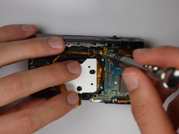

    • Remove remaining screw which holds the copper casing in the camera
  11. Sony DSC-RX100MA SD Motherboard Replacement: crwdns2935265:011crwdnd2935265:01crwdnd2935265:03crwdne2935265:0 Sony DSC-RX100MA SD Motherboard Replacement: crwdns2935265:011crwdnd2935265:02crwdnd2935265:03crwdne2935265:0 Sony DSC-RX100MA SD Motherboard Replacement: crwdns2935265:011crwdnd2935265:03crwdnd2935265:03crwdne2935265:0
    • Using the plastic opening tools, carefully pry off the copper casing at the two pictured points.
    • Remove casing

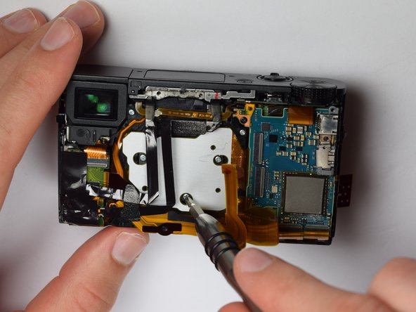

  12. Sony DSC-RX100MA SD Motherboard Replacement: crwdns2935265:012crwdnd2935265:01crwdnd2935265:03crwdne2935265:0 Sony DSC-RX100MA SD Motherboard Replacement: crwdns2935265:012crwdnd2935265:02crwdnd2935265:03crwdne2935265:0 Sony DSC-RX100MA SD Motherboard Replacement: crwdns2935265:012crwdnd2935265:03crwdnd2935265:03crwdne2935265:0
    • Using Philips Screwdriver, remove the four screws as marked on the picture
  13. Sony DSC-RX100MA SD Motherboard Replacement: crwdns2935265:013crwdnd2935265:01crwdnd2935265:03crwdne2935265:0 Sony DSC-RX100MA SD Motherboard Replacement: crwdns2935265:013crwdnd2935265:02crwdnd2935265:03crwdne2935265:0 Sony DSC-RX100MA SD Motherboard Replacement: crwdns2935265:013crwdnd2935265:03crwdnd2935265:03crwdne2935265:0
    • Place your finger into the battery port and push up on the SD card holder to push it out of its socket.
    • Give it a little wiggle and you should feel the SD card holder come out.
