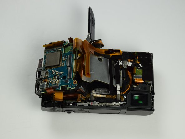

  9. Sony DSC-RX100MA Image Sensor Replacement: crwdns2935265:09crwdnd2935265:01crwdnd2935265:02crwdne2935265:0 Sony DSC-RX100MA Image Sensor Replacement: crwdns2935265:09crwdnd2935265:02crwdnd2935265:02crwdne2935265:0
    • Carefully unplug ribbon connector to fully detach LCD screen assembly from camera

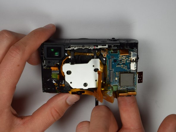

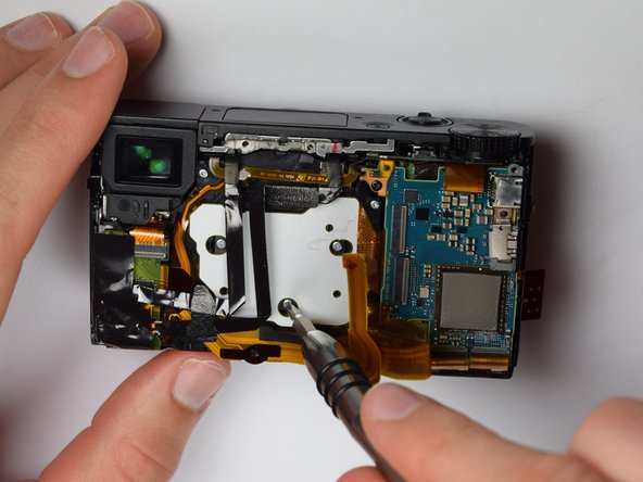

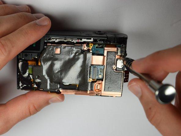

  10. Sony DSC-RX100MA Image Sensor Replacement, Image Sensor: crwdns2935265:010crwdnd2935265:01crwdnd2935265:02crwdne2935265:0 Sony DSC-RX100MA Image Sensor Replacement, Image Sensor: crwdns2935265:010crwdnd2935265:02crwdnd2935265:02crwdne2935265:0
    • Using the Philips Screwdriver, remove the screw (black 3mm) located on the copper casing.

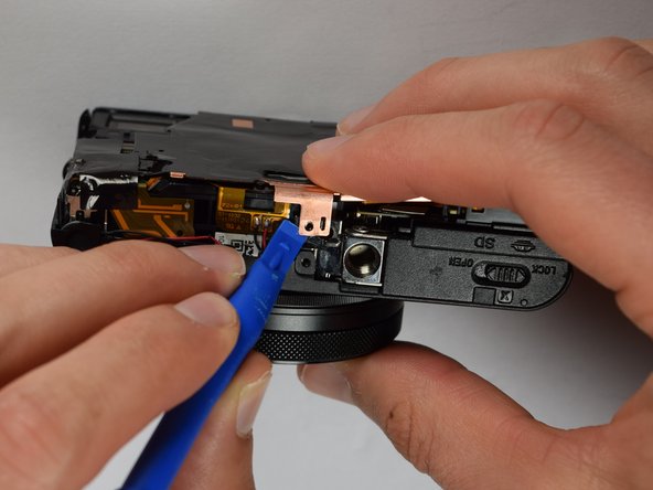

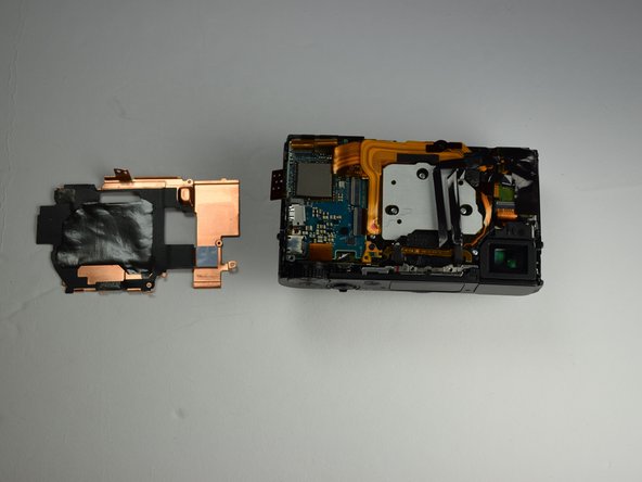

  11. Sony DSC-RX100MA Image Sensor Replacement: crwdns2935265:011crwdnd2935265:01crwdnd2935265:03crwdne2935265:0 Sony DSC-RX100MA Image Sensor Replacement: crwdns2935265:011crwdnd2935265:02crwdnd2935265:03crwdne2935265:0 Sony DSC-RX100MA Image Sensor Replacement: crwdns2935265:011crwdnd2935265:03crwdnd2935265:03crwdne2935265:0
    • Using the plastic opening tools, carefully pry off the copper casing at the two pictured points.
    • Remove casing.

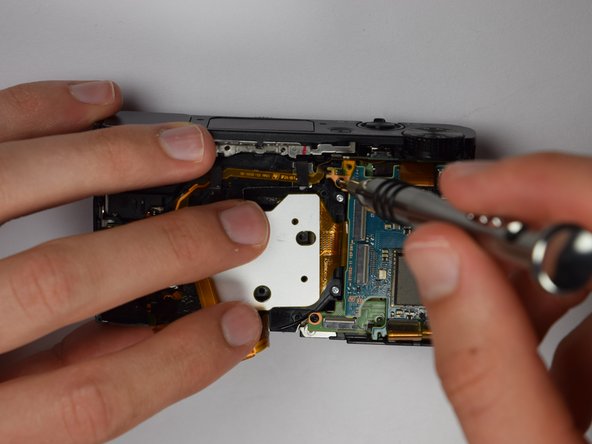

  12. Sony DSC-RX100MA Image Sensor Replacement: crwdns2935265:012crwdnd2935265:01crwdnd2935265:03crwdne2935265:0 Sony DSC-RX100MA Image Sensor Replacement: crwdns2935265:012crwdnd2935265:02crwdnd2935265:03crwdne2935265:0 Sony DSC-RX100MA Image Sensor Replacement: crwdns2935265:012crwdnd2935265:03crwdnd2935265:03crwdne2935265:0
    • Using the Philips screwdriver, remove the three (silver 3mm) screws
    • Remove the screw (silver 2mm) from the upper right hand corner
  13. Sony DSC-RX100MA Image Sensor Replacement: crwdns2935265:013crwdnd2935265:01crwdnd2935265:03crwdne2935265:0 Sony DSC-RX100MA Image Sensor Replacement: crwdns2935265:013crwdnd2935265:02crwdnd2935265:03crwdne2935265:0 Sony DSC-RX100MA Image Sensor Replacement: crwdns2935265:013crwdnd2935265:03crwdnd2935265:03crwdne2935265:0
    • Place your finger into the battery port and push up on the SD card holder to push it out of its socket.
    • Give it a little wiggle and you should feel the SD card holder come out.
  14. Sony DSC-RX100MA Image Sensor Replacement: crwdns2935265:014crwdnd2935265:01crwdnd2935265:01crwdne2935265:0
    • Now you can remove the marked gold ribbon cable from the SD card holder.
    • Utilize extreme caution while removing because the ribbon cables are extremely fragile and important to the camera.
