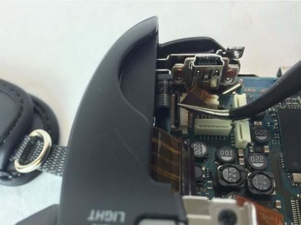

    • Remove all ribbon connectors from the motherboard using tweezers. Simply grab each ribbon cable and pull straight out of the connector.
    • Be careful not to bend the ribbon cables.

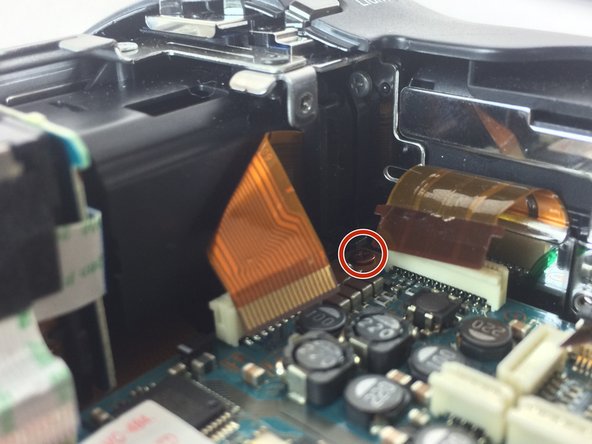

    • There is a hidden wire on the bottom of the board that should also be removed.
  7. Sony DCR-DVD 108 Motherboard Replacement: crwdns2935265:07crwdnd2935265:01crwdnd2935265:03crwdne2935265:0 Sony DCR-DVD 108 Motherboard Replacement: crwdns2935265:07crwdnd2935265:02crwdnd2935265:03crwdne2935265:0 Sony DCR-DVD 108 Motherboard Replacement: crwdns2935265:07crwdnd2935265:03crwdnd2935265:03crwdne2935265:0

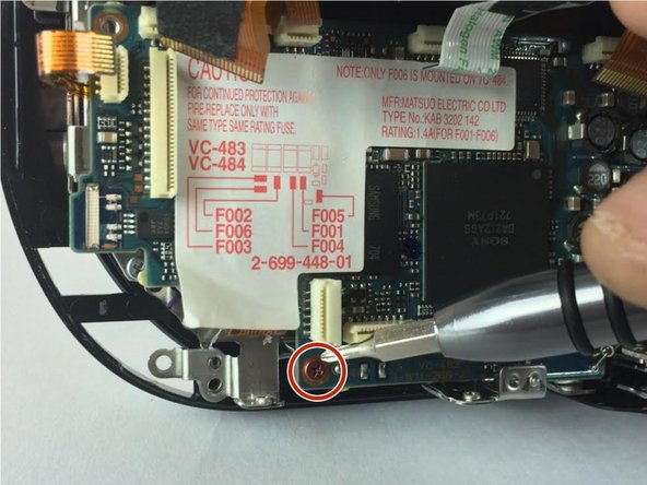

    • Remove 3 brown copper screws. Each copper screw has a #0 Phillips head and is 2.8mm in length.
  8. Sony DCR-DVD 108 Motherboard Replacement: crwdns2935265:08crwdnd2935265:01crwdnd2935265:01crwdne2935265:0
    • Lift the motherboard up from the outside edges to remove.
