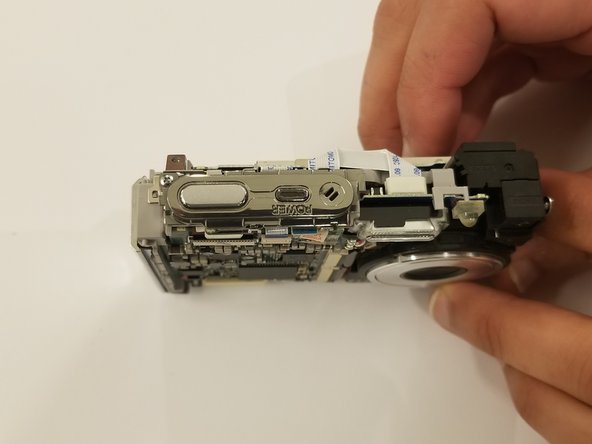

  6. Sony Cybershot DSC-W830 Motherboard Replacement, Lens: crwdns2935265:06crwdnd2935265:01crwdnd2935265:03crwdne2935265:0 Sony Cybershot DSC-W830 Motherboard Replacement, Lens: crwdns2935265:06crwdnd2935265:02crwdnd2935265:03crwdne2935265:0 Sony Cybershot DSC-W830 Motherboard Replacement, Lens: crwdns2935265:06crwdnd2935265:03crwdnd2935265:03crwdne2935265:0
    • Disconnect all ribbon cables by using the flat end of a spudger to lift up the black tabs on the ZIF connectors.
    • Once disconnected, use your fingers to lift lens out of the frame.

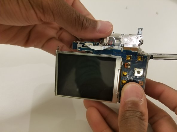

  7. Sony Cybershot DSC-W830 Motherboard Replacement, LCD Screen: crwdns2935265:07crwdnd2935265:01crwdnd2935265:03crwdne2935265:0 Sony Cybershot DSC-W830 Motherboard Replacement, LCD Screen: crwdns2935265:07crwdnd2935265:02crwdnd2935265:03crwdne2935265:0 Sony Cybershot DSC-W830 Motherboard Replacement, LCD Screen: crwdns2935265:07crwdnd2935265:03crwdnd2935265:03crwdne2935265:0
    • Lift the power button board up off of the daughterboard.
  8. Sony Cybershot DSC-W830 Motherboard Replacement: crwdns2935265:08crwdnd2935265:01crwdnd2935265:01crwdne2935265:0
    • Remove the single Phillips #000 screw.
    • Use your hands to remove the blue daughterboard.
  9. Sony Cybershot DSC-W830 Motherboard Replacement: crwdns2935265:09crwdnd2935265:01crwdnd2935265:02crwdne2935265:0 Sony Cybershot DSC-W830 Motherboard Replacement: crwdns2935265:09crwdnd2935265:02crwdnd2935265:02crwdne2935265:0
    • Flip the camera around.
    • Remove the black and orange ribbon cables.
  10. Sony Cybershot DSC-W830 Motherboard Replacement, Motherboard: crwdns2935265:010crwdnd2935265:01crwdnd2935265:01crwdne2935265:0
    • Remove the two remaining ribbon cables.
    • Pull the motherboard from the camera.
