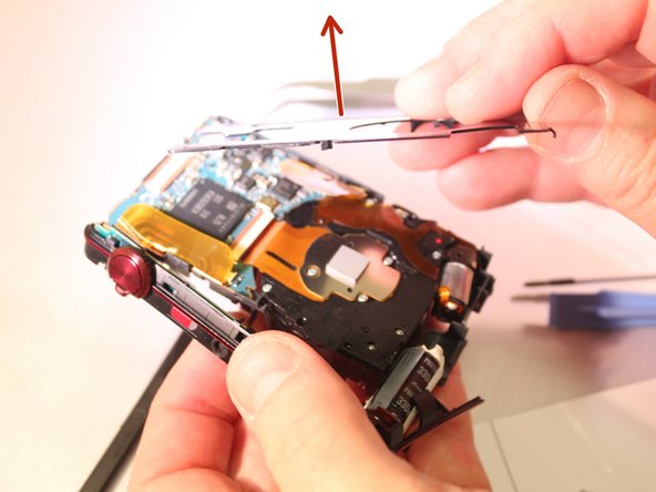

  5. Sony Cyber-shot DSC-WX80 Lens Replacement, Lens: crwdns2935265:05crwdnd2935265:01crwdnd2935265:02crwdne2935265:0 Sony Cyber-shot DSC-WX80 Lens Replacement, Lens: crwdns2935265:05crwdnd2935265:02crwdnd2935265:02crwdne2935265:0
    • After the LCD screen has been removed there is a black metal plate that can be pulled off revealing the motherboard and the lens.

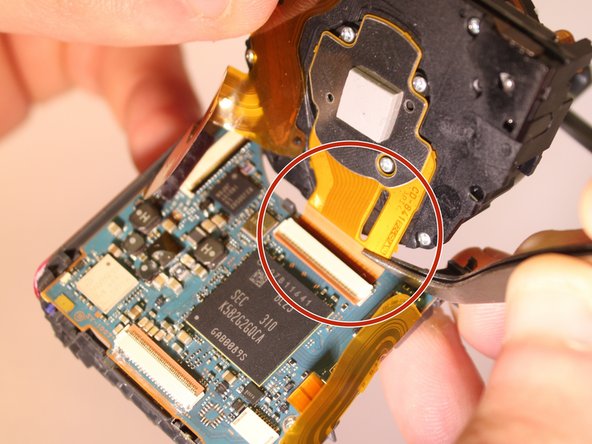

  6. Sony Cyber-shot DSC-WX80 Lens Replacement: crwdns2935265:06crwdnd2935265:01crwdnd2935265:02crwdne2935265:0 Sony Cyber-shot DSC-WX80 Lens Replacement: crwdns2935265:06crwdnd2935265:02crwdnd2935265:02crwdne2935265:0
    • To separate the motherboard from the lens there are two ribbon cables that need to be pulled out of their ports using tweezers.
    • Now that the Lens has been removed from the motherboard you can replace it!
