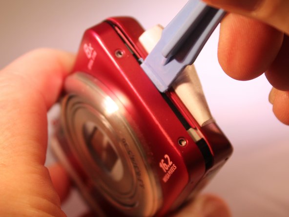

    • Begin by removing all six 40mm by 10mm black screws holding the outer frame together with the Phillips #00 screwdriver.
  2. Sony Cyber-shot DSC-WX80 LCD Screen Replacement: crwdns2935265:02crwdnd2935265:01crwdnd2935265:03crwdne2935265:0 Sony Cyber-shot DSC-WX80 LCD Screen Replacement: crwdns2935265:02crwdnd2935265:02crwdnd2935265:03crwdne2935265:0 Sony Cyber-shot DSC-WX80 LCD Screen Replacement: crwdns2935265:02crwdnd2935265:03crwdnd2935265:03crwdne2935265:0
    • Remove the free-moving flap near the battery port and store in a safe place.
    • Pry the front cover off gently. Use a plastic opening tool if available.
    • Now pry the back cover off gently, using a plastic opening tool if available.

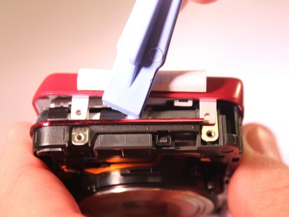

    • Remove the #00 screw from the right hand side (from the LCD screen side) which is adjacent to the master control dial.
    • Use a spudger or plastic opening tools to pry up the LCD screen and free the two metal tangs on the left side.
    • Lift up two more metal tabs held down by a thin red plastic strap on the right (master control dial) side. Reference the third image.
    • The thin red plastic strap is very fragile.
