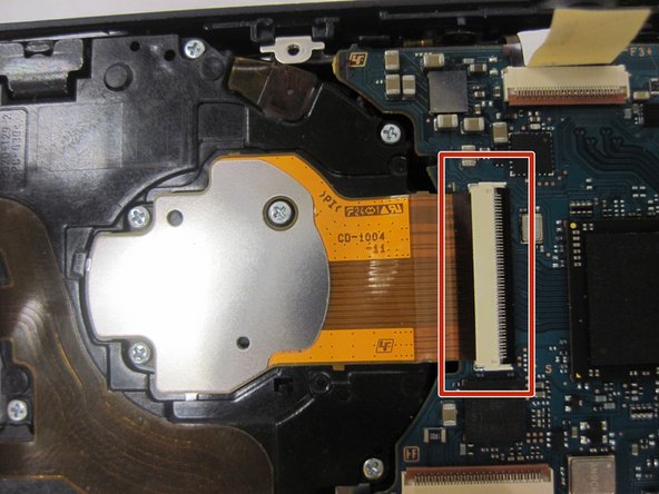

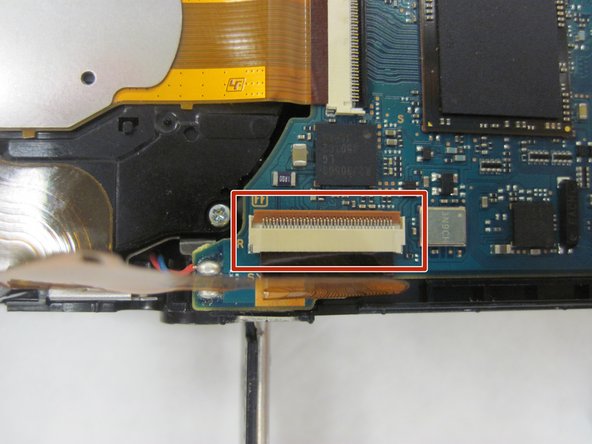

  8. Sony Cyber-shot DSC-WX350 Lens Assembly Replacement: crwdns2935265:08crwdnd2935265:01crwdnd2935265:03crwdne2935265:0 Sony Cyber-shot DSC-WX350 Lens Assembly Replacement: crwdns2935265:08crwdnd2935265:02crwdnd2935265:03crwdne2935265:0 Sony Cyber-shot DSC-WX350 Lens Assembly Replacement: crwdns2935265:08crwdnd2935265:03crwdnd2935265:03crwdne2935265:0
    • Now take out the 3 zifs by first opening the zif latch with your fingers and then sliding it out.

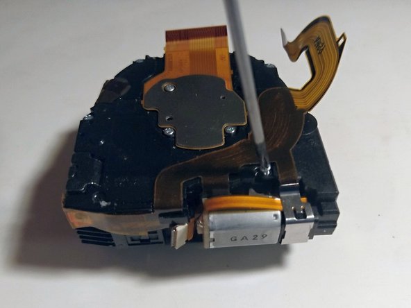

  10. Sony Cyber-shot DSC-WX350 Lens Assembly Replacement: crwdns2935265:010crwdnd2935265:01crwdnd2935265:02crwdne2935265:0 Sony Cyber-shot DSC-WX350 Lens Assembly Replacement: crwdns2935265:010crwdnd2935265:02crwdnd2935265:02crwdne2935265:0
    • In order to access the CCD, loosen the 3 screws holding its metal lid.
    • In order to access the lens mechanics, take out the 4 3mm screws on the edge of the lid, then the single 3 mm screw next to the motor.

  12. Sony Cyber-shot DSC-WX350 Lens Assembly Replacement: crwdns2935265:012crwdnd2935265:01crwdnd2935265:02crwdne2935265:0 Sony Cyber-shot DSC-WX350 Lens Assembly Replacement: crwdns2935265:012crwdnd2935265:02crwdnd2935265:02crwdne2935265:0
    • Pull out the cogwheel with the drive unit.
    • Now you can access the lens inner mechanics. You might wanna cover the CCD and the inner lens opening with tape to prevent dust from entering before you try to clean anything.
