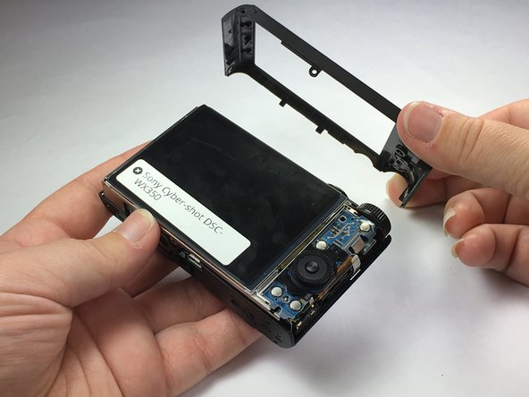

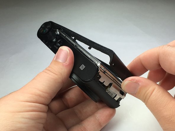

  5. Sony Cyber-shot DSC-WX350 LCD Screen Replacement: crwdns2935265:05crwdnd2935265:01crwdnd2935265:03crwdne2935265:0 Sony Cyber-shot DSC-WX350 LCD Screen Replacement: crwdns2935265:05crwdnd2935265:02crwdnd2935265:03crwdne2935265:0 Sony Cyber-shot DSC-WX350 LCD Screen Replacement: crwdns2935265:05crwdnd2935265:03crwdnd2935265:03crwdne2935265:0
    • Separate the back of the camera frame from the body by taking apart the bottom and the sides of the camera.
    • This will require a little force. You will feel tension and hear clicking noises. That is normal.

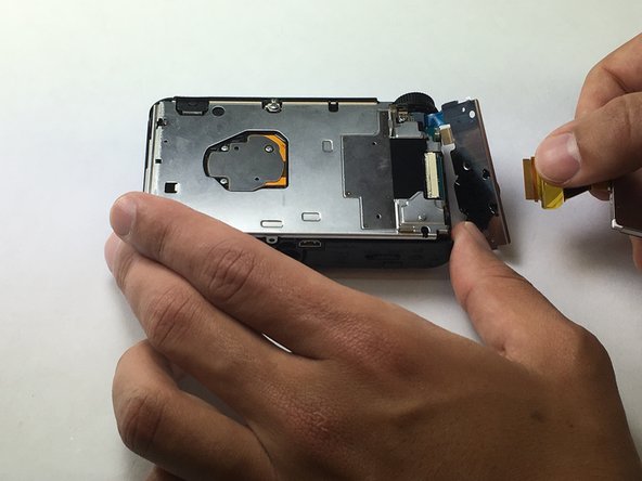

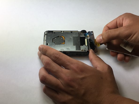

    • With a plastic opening tool, lift the LCD screen from the camera body.
  8. Sony Cyber-shot DSC-WX350 LCD Screen Replacement: crwdns2935265:08crwdnd2935265:01crwdnd2935265:03crwdne2935265:0 Sony Cyber-shot DSC-WX350 LCD Screen Replacement: crwdns2935265:08crwdnd2935265:02crwdnd2935265:03crwdne2935265:0 Sony Cyber-shot DSC-WX350 LCD Screen Replacement: crwdns2935265:08crwdnd2935265:03crwdnd2935265:03crwdne2935265:0
    • Set the LCD screen to the side
    • Grab the orange band holding the LCD screen and gently pull to detach from the camera body.
    • Do not pull the white strip on top of the orange band. This is part of the circuit inside the camera and detaching this piece could permanently damage your camera.

This worked a treat! Thank you!! Getting the new connector is in very fiddly and also watch where the extra strip goes when you remove it and try for the same on the new one. It sort of tucks back on itself.

allocate lots of time and a clean work space……and i needed to be bold when handling the yellow strip……i didnt get it slotted far enough in the first try, and had the ‘folding in on itself’ to the side, rather than back underneeth the screen. I handled it more firmly on the second try.
