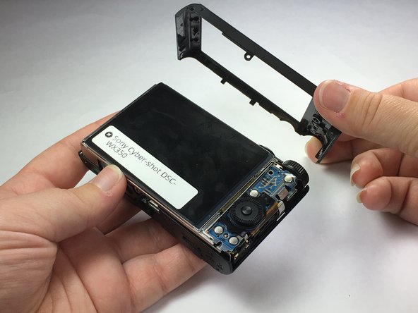

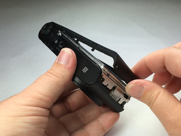

  5. Sony Cyber-shot DSC-WX350 Control Wheel Replacement: crwdns2935265:05crwdnd2935265:01crwdnd2935265:03crwdne2935265:0 Sony Cyber-shot DSC-WX350 Control Wheel Replacement: crwdns2935265:05crwdnd2935265:02crwdnd2935265:03crwdne2935265:0 Sony Cyber-shot DSC-WX350 Control Wheel Replacement: crwdns2935265:05crwdnd2935265:03crwdnd2935265:03crwdne2935265:0
    • Separate the back of the camera frame from the body by taking apart the bottom and the sides of the camera.
    • This will require a little force. You will feel tension and hear clicking noises. That is normal.

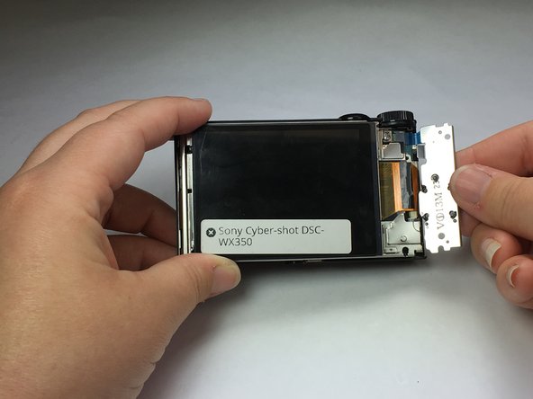

  6. Sony Cyber-shot DSC-WX350 Control Wheel Replacement: crwdns2935265:06crwdnd2935265:01crwdnd2935265:02crwdne2935265:0 Sony Cyber-shot DSC-WX350 Control Wheel Replacement: crwdns2935265:06crwdnd2935265:02crwdnd2935265:02crwdne2935265:0
    • To remove the control wheel from its position, grab the bottom of the part and pivot to the side and away from the camera.
    • After the part is fully away from the camera, move the part downward and out. It should now be fully extended and able to bend at the band that is attached to the body.
  7. Sony Cyber-shot DSC-WX350 Control Wheel Replacement: crwdns2935265:07crwdnd2935265:01crwdnd2935265:02crwdne2935265:0 Sony Cyber-shot DSC-WX350 Control Wheel Replacement: crwdns2935265:07crwdnd2935265:02crwdnd2935265:02crwdne2935265:0
    • Pull blue band holding the control wheel away from the camera body.
