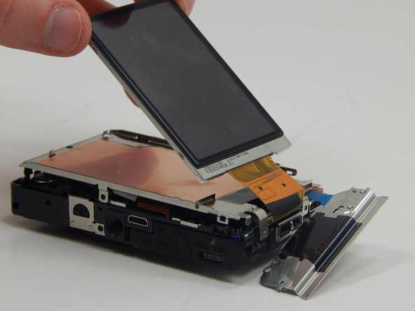

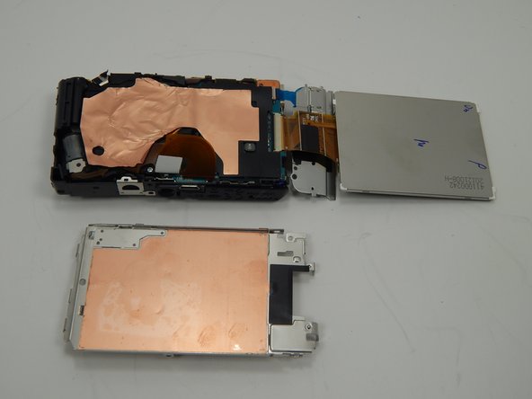

  6. Sony Cyber-shot DSC-WX100 LCD Screen Replacement: crwdns2935265:07crwdnd2935265:01crwdnd2935265:03crwdne2935265:0 Sony Cyber-shot DSC-WX100 LCD Screen Replacement: crwdns2935265:07crwdnd2935265:02crwdnd2935265:03crwdne2935265:0 Sony Cyber-shot DSC-WX100 LCD Screen Replacement: crwdns2935265:07crwdnd2935265:03crwdnd2935265:03crwdne2935265:0
    • Remove this screw (1mm) with a Phillips #000 Screwdriver.
    • Gently lift the LCD from the metal plate.
    • Remove the metal plate that was underneath the LCD screen from the camera.
  7. Sony Cyber-shot DSC-WX100 LCD Screen Replacement: crwdns2935265:08crwdnd2935265:01crwdnd2935265:03crwdne2935265:0 Sony Cyber-shot DSC-WX100 LCD Screen Replacement: crwdns2935265:08crwdnd2935265:02crwdnd2935265:03crwdne2935265:0 Sony Cyber-shot DSC-WX100 LCD Screen Replacement: crwdns2935265:08crwdnd2935265:03crwdnd2935265:03crwdne2935265:0
    • Use the plastic opening tool to pry the black bar upwards.
    • Pull the LCD screen from out of the slot.
