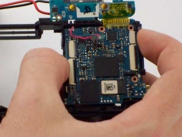

  15. Sony Cyber-shot DSC-W800 Motherboard Replacement: crwdns2935265:015crwdnd2935265:01crwdnd2935265:03crwdne2935265:0 Sony Cyber-shot DSC-W800 Motherboard Replacement: crwdns2935265:015crwdnd2935265:02crwdnd2935265:03crwdne2935265:0 Sony Cyber-shot DSC-W800 Motherboard Replacement: crwdns2935265:015crwdnd2935265:03crwdnd2935265:03crwdne2935265:0
    • Pull up on the bottom-half of the motherboard, slightly removing it from its position in the housing.
    • With enough force, pull up on the top right of the motherboard, pulling it entirely from its position in the housing.
    • Once again, be sure to keep the motherboard and secondary board connection intact.

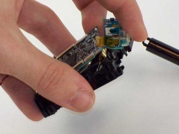

  16. Sony Cyber-shot DSC-W800 Motherboard Replacement: crwdns2935265:016crwdnd2935265:01crwdnd2935265:01crwdne2935265:0
    • Once apart, completely separate motherboard from the housing.
