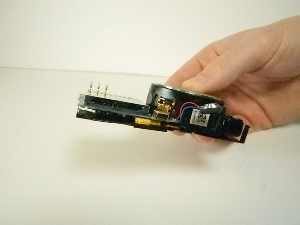

  16. Sony Cyber-shot DSC-W730 Mother Board Replacement: crwdns2935265:016crwdnd2935265:01crwdnd2935265:02crwdne2935265:0 Sony Cyber-shot DSC-W730 Mother Board Replacement: crwdns2935265:016crwdnd2935265:02crwdnd2935265:02crwdne2935265:0
    • Use tweezers to disconnect the ribbon located under the motherboard near the bottom of the camera.

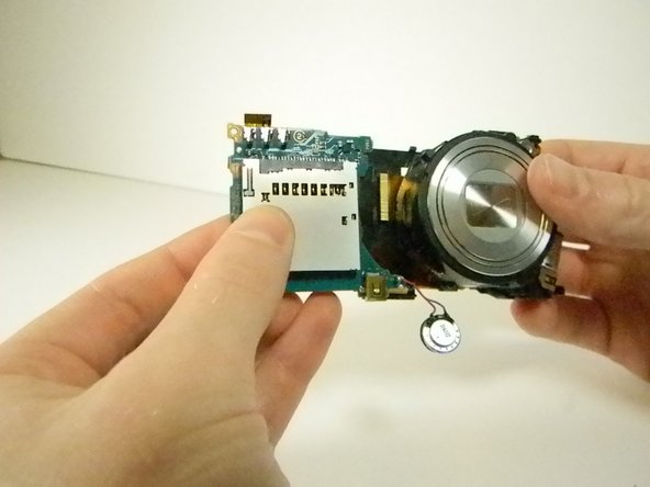

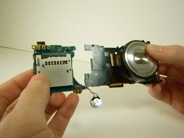

  17. Sony Cyber-shot DSC-W730 Mother Board Replacement: crwdns2935265:017crwdnd2935265:01crwdnd2935265:03crwdne2935265:0 Sony Cyber-shot DSC-W730 Mother Board Replacement: crwdns2935265:017crwdnd2935265:02crwdnd2935265:03crwdne2935265:0 Sony Cyber-shot DSC-W730 Mother Board Replacement: crwdns2935265:017crwdnd2935265:03crwdnd2935265:03crwdne2935265:0
    • Now with one hand located on the plastic skeleton and the other on the motherboard pull the motherboard to the left to disconnect the last ribbon.
