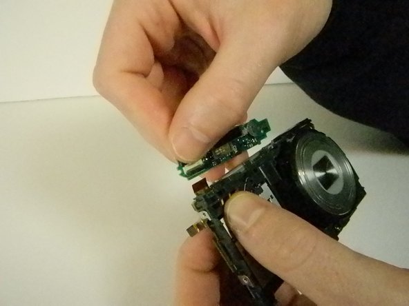

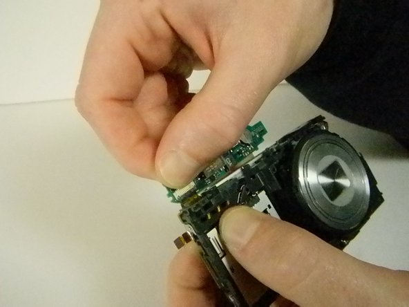

  7. Sony Cyber-shot DSC-W730 Flash Control Board Replacement, Caption/Flash Control Board: crwdns2935265:07crwdnd2935265:01crwdnd2935265:03crwdne2935265:0 Sony Cyber-shot DSC-W730 Flash Control Board Replacement, Caption/Flash Control Board: crwdns2935265:07crwdnd2935265:02crwdnd2935265:03crwdne2935265:0 Sony Cyber-shot DSC-W730 Flash Control Board Replacement, Caption/Flash Control Board: crwdns2935265:07crwdnd2935265:03crwdnd2935265:03crwdne2935265:0
    • Once the case is off, hold down the ribbon near the LCD screen that connects the flash to the camera. While doing this, carefully lift the control board that contains the flash until the ribbon is no longer connected.
  8. Sony Cyber-shot DSC-W730 Flash Control Board Replacement: crwdns2935265:08crwdnd2935265:01crwdnd2935265:01crwdne2935265:0
    • Once you have removed the piece this is what it will look like.
