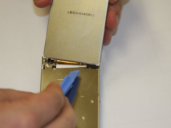

  10. Sony Cyber-shot DSC-W690 LCD screen Replacement: crwdns2935265:010crwdnd2935265:01crwdnd2935265:02crwdne2935265:0 Sony Cyber-shot DSC-W690 LCD screen Replacement: crwdns2935265:010crwdnd2935265:02crwdnd2935265:02crwdne2935265:0
    • Use spudger to pry apart the LCD screen from the support bracket.
