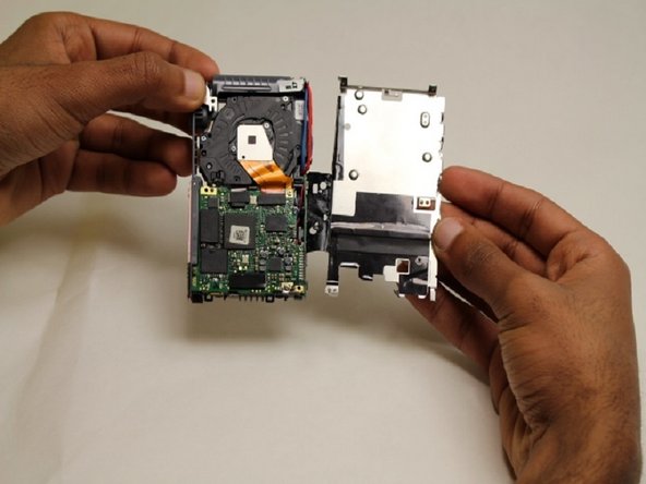

    • Remove the screws from the metal board using the Phillips #00 screwdriver.
    • Pop apart the metal board using the plastic opening tool.
    • Peel apart the black tape from the flash bulb.
    • Avoid touching the bulb as it will burn or shock if touched.

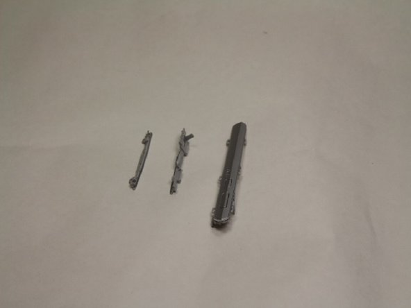

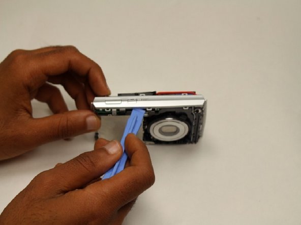

    • Pry open the remaining covers of the camera using the plastic opening tool.
    • Some parts may fall out during this process.
